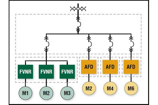

It is common industry practice to install standard full-voltage starters and VFDs in distinctly different configurations. On the one hand, full-voltage starters are usually contained within the same medium-voltage motor control center (MCC) lineup and fed by common bus, so as to save space and the extra cost of installation. On the other hand, VFDs are often installed individually and treated as independent systems (see Figure 1). Yet, it is advantageous to integrate drives into motor control centers (see Figure 2).

To show the advantages of creating a single lineup, it is helpful to compare various configurations for a common situation. This example will address a specific requirement of six motor controllers fed from a common transformer. The transformer, its protection, and the size and control requirements of the motors will be the same across all configurations discussed. The specific area addressed will be the feeder portion between the transformer and the individual motor controllers (see Figure 3).
In this example, the system receives input power through a 10 MVA, 4,160-V transformer, and the transformer load is protected by a 2,000-A breaker. The transformer, its protection, and the feed to the 2,000-A breaker remains constant for all scenarios, and is therefore not addressed in the individual scenarios described.
The load for the system will be three full voltage non-reversing (FVNR) starters and three VFDs that range from 1,000 hp to 2,500 hp. Each motor is a typical medium-voltage induction motor. A detailed explanation of each motor’s control requirements is listed in Table 1.

Scenario #1
In the first scenario, the only common buses that exist are in the medium-voltage switchgear and the starter MCC. The medium-voltage switchgear has one main and four individual feeder breakers that supply the stand-alone VFDs and the starter MCC. This scenario requires that four feeder cables be installed from the feeder breakers. This is the typical configuration in many applications today. Equipment and space requirements are:
- Distribution gear
- 18-in. incoming section
- 5-breaker switchgear
- Cabling (4)
- Floor space required is 102.65 sq ft.
