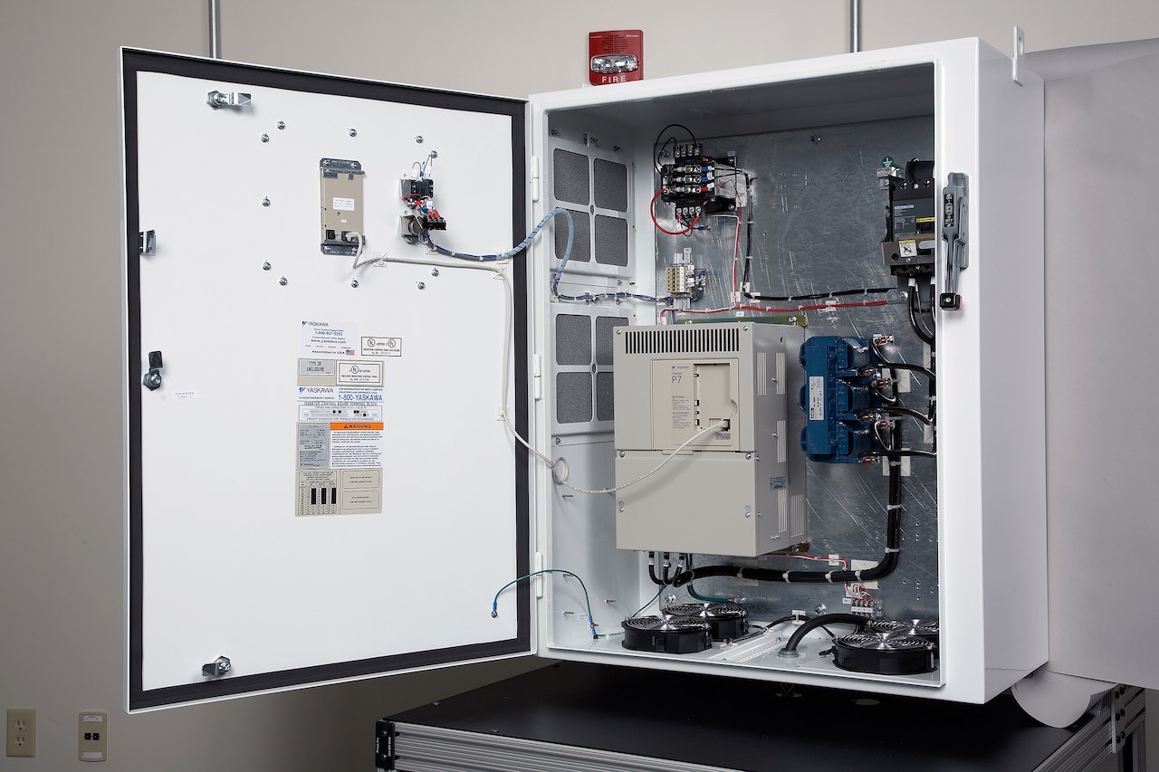

An existing package or setup also will need to be looked at closely. Most stand-alone VFDs are rated simply for an indoor environment with little to no protection against airborne debris. They are often put inside an enclosure, which offers greater resistance against harmful elements such as dust and water. Replacing the unit as a whole (drive and enclosure) can get pricey, and only the drive itself may have failed. Swapping the VFD may seem logical but components such as circuit breakers, filters, bypass configurations and other electrical equipment need to be examined for compatibility.
