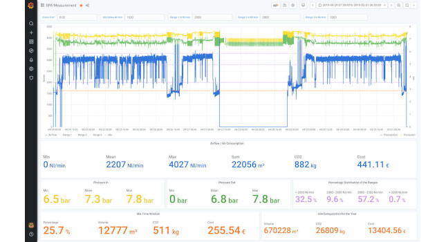

Smart pneumatics, on the other hand, continuously monitor airflow. Some sensors can collect and provide real-time insights on flow, while also capturing pressure and temperature data in the feed line, enabling advanced diagnosis of the operating parameters. These solutions can often easily retrofit to existing machines with the use of edge gateways. Around-the-clock software monitoring can detect leaks in near-real time. The software identifies the machine in question and sends notification alerts directly to maintenance staff so they can further investigate.
By detecting leaks in near-real time, smart pneumatics can lower compressed air energy spend by 10-20% and reduce a plant’s CO2 footprint by 10%. Addressing compressed air leaks earlier also reduces both planned (time used to test for air leakages on each machine) and unplanned downtime and improves overall equipment efficiency (OEE).
Optimize consumption
Some manufacturers may not have the full picture when it comes to the relationship between air pressure and airflow. This means they may not actually know the optimal consumption point of compressed air for their manufacturing process. The air pressure in their industrial machines may be higher than it needs to be. When equipment consumes more compressed air than necessary, it consumes more energy, which raises energy costs and CO2 emissions.
Smart sensors plus an edge computing device can collect data about air pressure and airflow. By analyzing the edge analytics of the pneumatic system, plants can get a clearer picture of the relationship between air pressure and flow. By lowering the overall pressure of their pneumatic system, they can reduce the airflow to a certain point while maintaining the same cylinder cycle time.
Finding the optimal ratio between pressure and flow can lead to a 10-20% reduction of compressed air consumption and energy costs, as well as a 10% reduction in CO2 footprint, without affecting production. This allows manufacturers to maintain current cycle times in production, but with lower energy consumption, costs and CO2 emissions.
