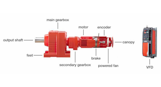

Figure 1: A drive and some of its optional accessories. Courtesy: SEW-EURODRIVE

The drive train
The drive train contains everything that powers the application, including the drive itself. The drive (see Figure 1) has three core components: a gearbox, an electric motor and a variable frequency drive (VFD). It may connect directly to the application or it may deliver power through additional transmission elements, such as a belt, chain or spindle. In either case, the drive must have appropriate coupling and mounting devices. These include flexible couplings, flanges, feet or torque arms.
The motor may require a brake, either to stop the load or hold it in place. If the application requires precise speed control or accurate positioning, a motor encoder will be necessary. When a programmable logic controller (PLC) or other industrial controller manages the application, the VFD will probably need a suitable fieldbus interface or some extra inputs and outputs.

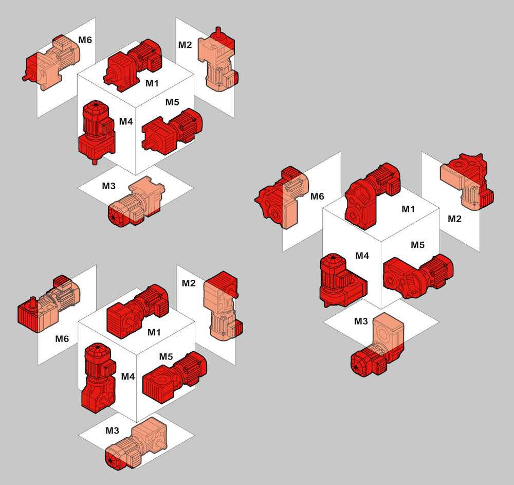

Figure 2: Gearbox mounting position identifiers vary among manufacturers. This is SEW-EURODRIVE’s system. Courtesy: SEW-EURODRIVE

You can improve efficiency even further by requesting a particular gearbox style and mounting position. Gearboxes based on helical and/or bevel gears tend to be much more efficient than those containing worm gears, so they’re preferable when efficiency is paramount.
Similarly, the gearbox mounting position influences efficiency because position determines how much oil the housing must contain to keep the gear stages lubricated. Vertical mounting positions often require more lubricant, which leads to higher churning losses as the gears plow through the oil.
Whenever possible, select a mounting position that requires the least lubricant. Every manufacturer has its own mounting position identification scheme (see Figure 2). Be sure that you understand it, so you can correctly specify the gearbox mounting position.
