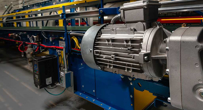

Designers are, at times, overwhelmed by the wide variety of motor manufacturers, styles and sizes available. Typical motors may be ac or dc, for fixed or variable speed, with steppers and servos as options for high-precision applications. Each style has certain strengths, but all applications must be sized to operate the load under all normal conditions. The focus of this article is on basic ac motors (see Figure 1).
Knowing how to select the right size motor for a given application requires a methodical look at the requirements. For any machine builder or OEM, cost is always a key consideration. Beyond that, an evaluation of the environmental conditions, operational requirements and available power will lead users down the right path. This article reviews the basic considerations and steps for properly selecting and sizing electric motors.

Constant torque loads are the most straightforward applications. These are loads where the required torque does not vary much with the speed. This is common for conveyors, compressors and cranes (see Figure 2). The horsepower requirement does vary with speed or how much work is effectively being performed. For these constant torque applications, it is necessary to determine the load experienced by the motor in order to select the proper horsepower. This may be indicated on the nameplate of the driven machine, or from torque testing to determine the amount of required force. The minimum required horsepower is calculated using the formula:
