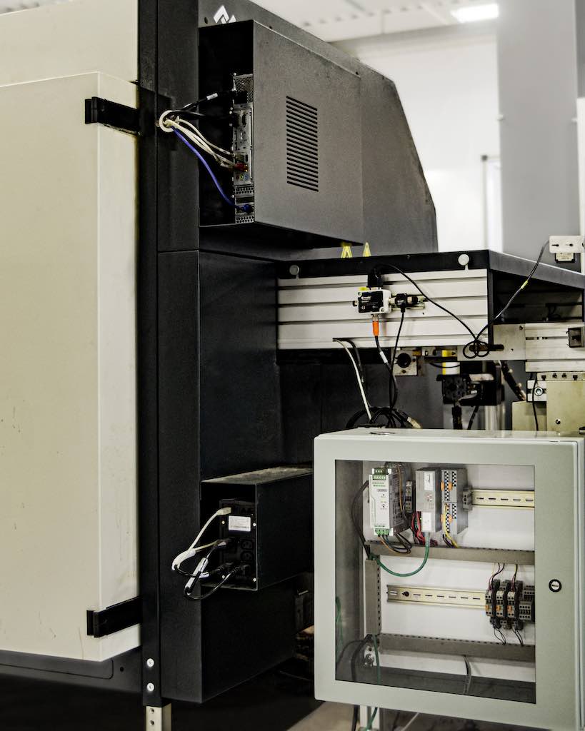

Connection-enabled equipment provides access through a standard interface, primarily OPC UA. Most of this equipment is purchased from machine manufacturers that provide connectivity as standard. Examples of this equipment include surface-mount line modules, automatic test equipment and semiautomated packaging. New custom or semi-custom locally sourced machines have an open-source controller, which also acts as an message queuing telemetry transport (MQTT) server. This provides the same connectivity as the stand-alone machines and workstations (Figure 2).
Stand-alone machines and workstations make up a large portion of existing assets in production and include manual, semi-automatic and fully automatic machines or work areas. Â These are controlled by industrial computers or earlier-generation programmable logic controllers (PLCs). The machines are part of daily production, so the project team needed a low-risk, noninvasive approach to connect the equipment. The inputs are often parallel wired in the control cabinet, to the sensors with the desired data. These are wired back to an open-source controller, which acts as an MQTT gateway to the production network.

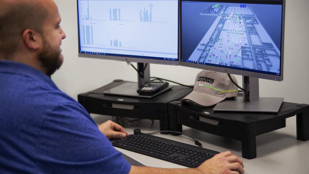

The digital twin was the first step toward this, providing situational awareness. Here is one way to explain it: A user finds something on the operator interface in the same place located on the production floor. If a particular machine is located outside of the production entrance and to the right, the user will find it there on the digital twin graphic. The machine graphic allows access to basic information: whether on or off, the number of units produced or rejected and more. It also includes any current process improvement projects, with status in the process or production area. The KPI board locations in production can be accessed electronically through the digital twin, as well.

The digital twin is active and it’s been kept updated with new equipment installations and plant relayout activities. The current digital machine status is available. Several machines’ data can be displayed through open-source software. A digitalization steering committee comprising operations and IT personnel has been formed to lead the qualification, deployment and standardization of applications involving analytics and visualization. The first programs involved the expansion of the existing MES applications across all areas of production. This is almost complete.
