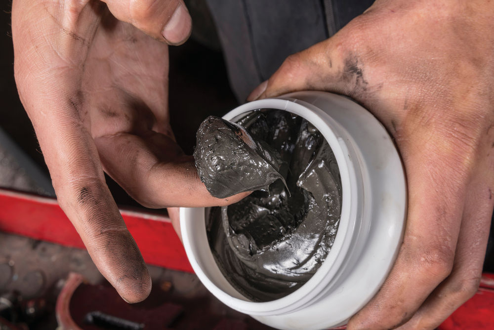

Anoop Kumar, senior staff scientist with Chevron in Richmond, Calif., stated that while advancements have occurred in how grease is made, ā€œgrease manufacturing is still considered an art because the properties of the final grease product hinge on so many factors, including the equipment used, the processing parameters, and the experience of the personnel involved in the manufacturing.ā€
Figure 1. Grease manufacturing is an art that continues to evolve as end-user needs develop and the market refines its requirements. Courtesy of STLE.

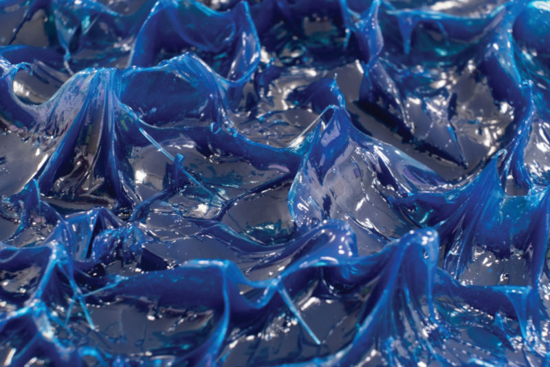

A wide range of materials can act as grease additives, depending on the final properties sought for the grease. Additives also can be solid materials, like graphite, to provide protection under heavy loads, or ceramic powder to protect in static high-pressure applications.
Figure 2. Grease additives can also be solid materials, like graphite, to provide protection under heavy loads. Courtesy of STLE.
