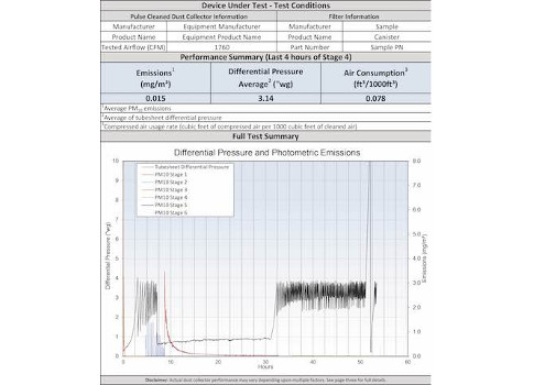

2. The test data
Standard 199 not only creates a uniform test for dust collectors; it requires a uniform report template as well. Summary data (see Figure 1) will include:
  • Emissions in mg/m3;
  • Differential pressure average in inches of water gauge; and
  • Air consumption in ft3/1,000ft3.
By design, reports from Standard 199 testing will require some informed analysis. Our committee decided not to reduce test results to a single rating as MERV did. A one-dimensional score can be misleading, especially with regard to emissions. By providing three absolute values, Standard 199 reports will enable plant managers to do accurate emissions reporting, meaningful cost-benefit analysis and easier side-by-side comparisons.
