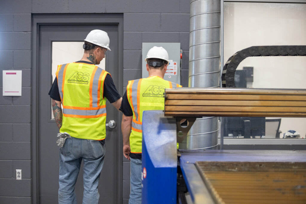

Figure 3: Supervisors conduct an onsite inspection of safety controls and facility exits to ensure unobstructed fire lanes. Courtesy: ACS
In terms of energy and equipment, the lockout/tagout (LOTO) program is arguably the most critical operational protocol. It is the guarantee that machinery will achieve a zero-energy state before maintenance begins, preventing accidental start-up.
For plant engineers, LOTO coordination and ensuring compliance with NFPA 70E: Standard for Electrical Safety in the Workplace for high-voltage work is nonnegotiable. Without this rigor, every maintenance operation carries the risk of a life-threatening accident and severe equipment damage.

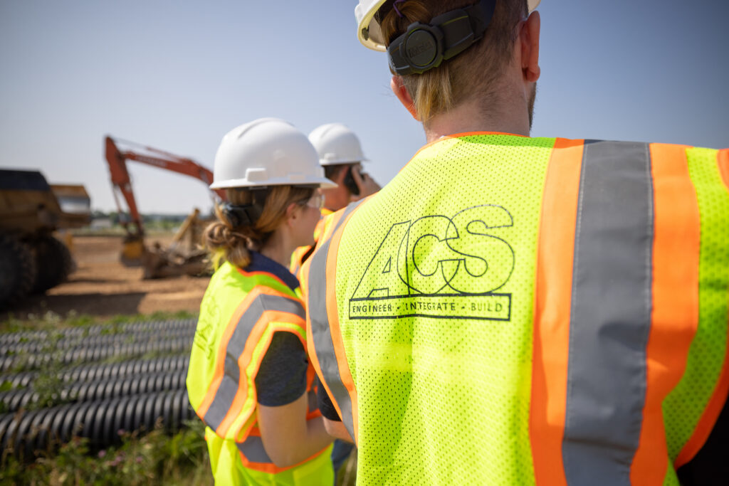

Figure 4: Management demonstrates active participation and visibility, wearing required high-visibility vests and hard hats while supervising the site. Courtesy: ACS
Getting PPE right starts with an assessment-first approach. Plant engineers can’t just hand out hard hats and call it a day. They must look at the specific hazards of the task at hand.
A safety expert should ask: Is the job overhead grinding? Then you need foam-lined safety glasses under your face shield. Is the worker near rotating machinery? Then you absolutely must enforce the removal of gloves to prevent entanglement. Is it high-heat work? You need to swap that standard synthetic high-visibility vest for natural fiber or fire-rated clothing. The PPE must fit the narrative, every single time.
