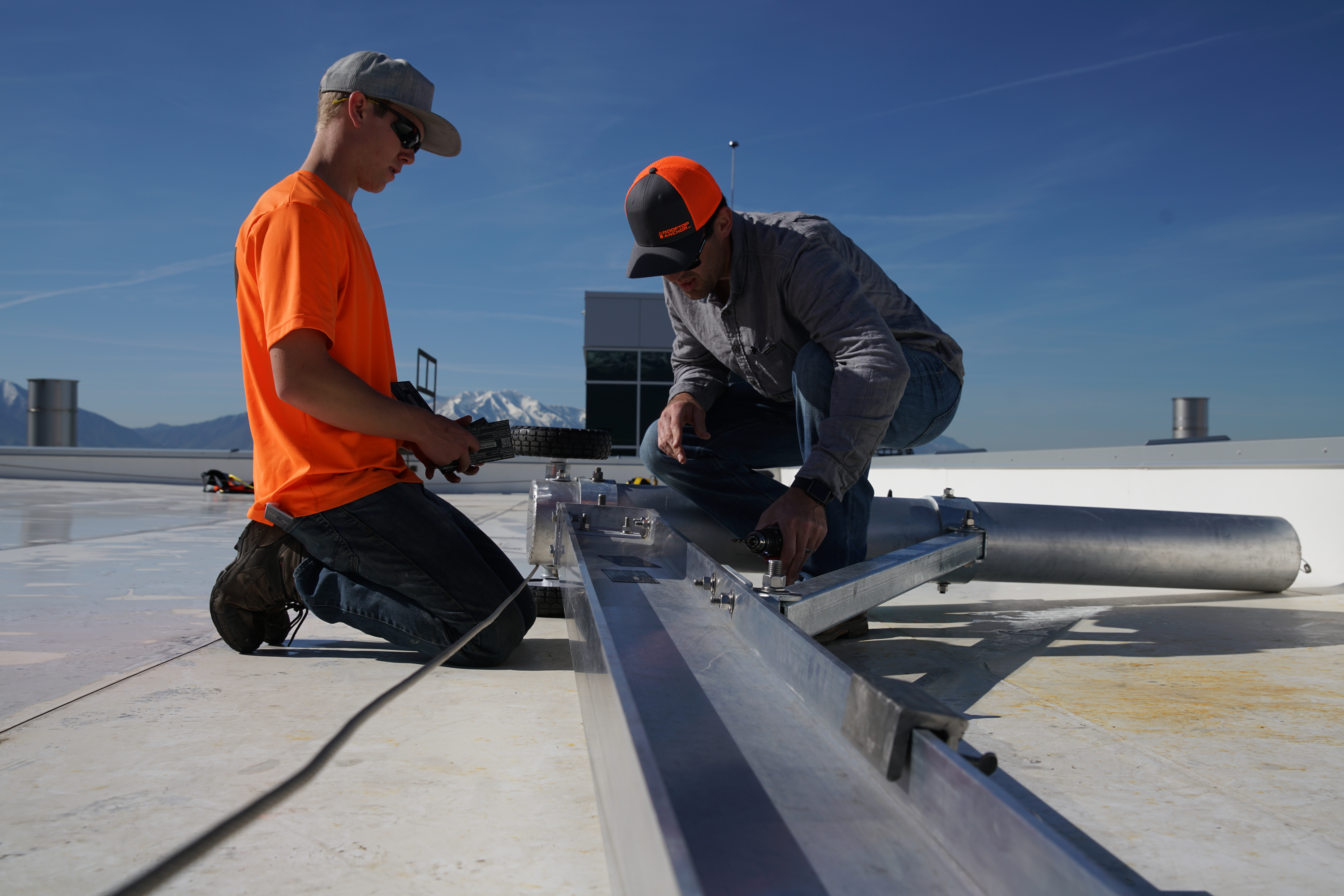

Q: I have certified anchors in my facility. Is recertification part of the inspection process?
A: Anchor certifications are related, but not the same thing. Noncertified and certified anchors are both subject to typical annual inspections as described earlier.
Certified anchorages for active fall protection systems (horizontal lifelines, single-point systems, etc.) must be recertified every five years. Among other qualifications, an engineer or qualified person must confirm that the anchorage system is rated at a minimum of a 2:1 safety factor for the anticipated fall forces.
Anchor posts and davit arms used for suspended access systems (window washing, rope descent, swing stage systems, etc.) must be recertified every 10 years. In this recertification process, the qualified person must, among other qualitative metrics, use a pull-testing device to confirm the anchorage is capable of withstanding static loads and dynamic loads that would be incurred from a fall.
