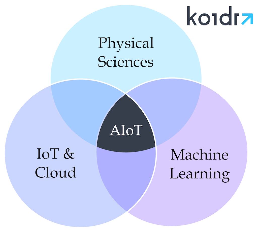

Figure 1: Koidra engages with end user clients of all types, providing products and services designed to help these users create artificial intelligence of things (AIoT) functionality by easily integrating data, creating soft sensors, implementing low-code control, and enabling autonomous control. Courtesy: Koidra
