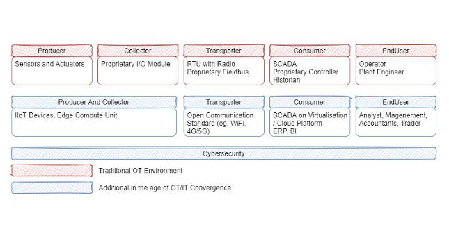

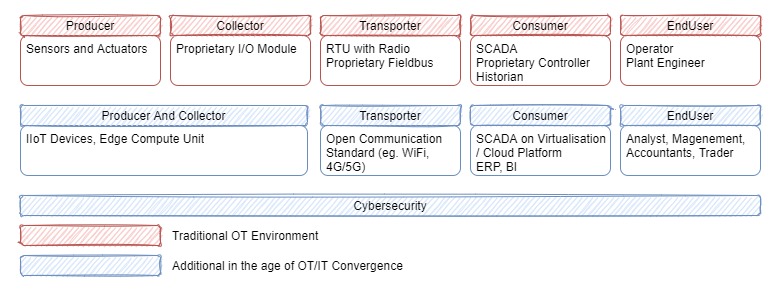

1. Technological adaptability competency. Technological adaptability refers to competency to proactively learn and understand emerging technologies related to a solution. Figure 1 illustrates the additional complexities added to the OT environment due to IT/OT convergence from a data perspective. The additional connectivity to enterprise resource planning (ERP)/business intelligence (BI) applications and end users from management further strengthen the relationship between operational data and profitability.
Figure 1: Typical OT environment in the age of OT/IT convergence. Courtesy: Optimate

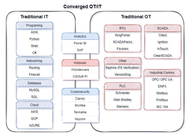

The introduction of virtualization technology, cloud platforms, Industrial Internet of Things (IIoT) and open communication standards have made the adoption of new technologies much easier and affordable. Figure 2 indicates the variety of technical areas an SI engineer may encounter in the implementation of an OT solution in the new era. This is by no means comprehensive, but a reasonable list of common technologies. It is next to impossible for one to master all aspects of those technologies, therefore efficiently identify and understand the core aspects of the technologies relevant to the OT solution will be the key to any successful implementation.

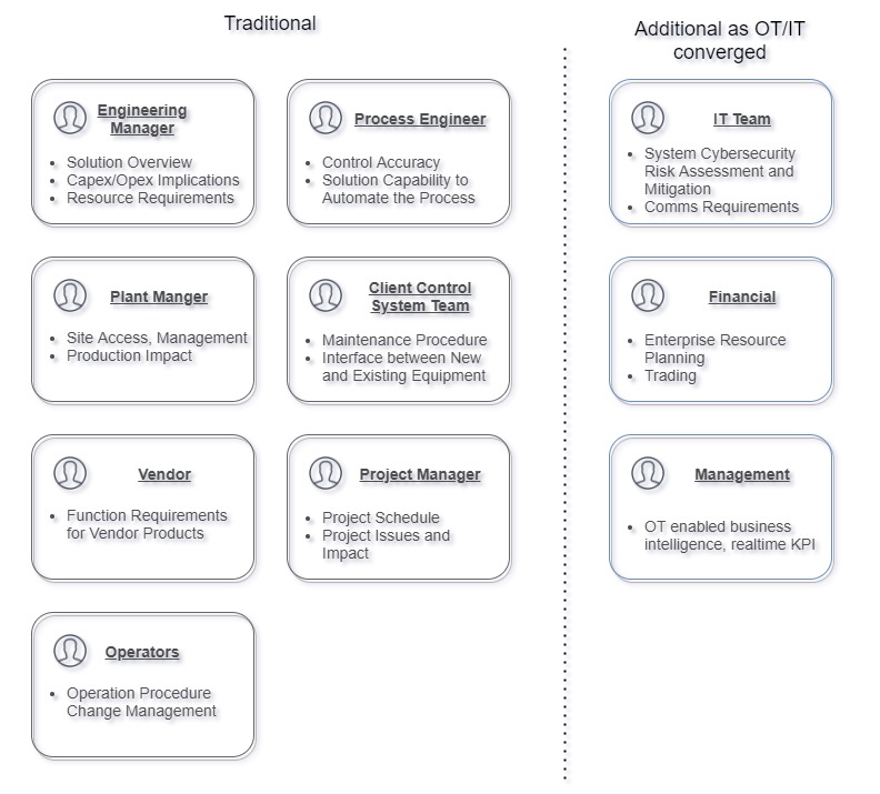

2. Interpersonal communication competency. Essential interpersonal communication skills enable SI engineers to convey technical solutions to different stakeholders to obtain their support in the project. Traditional stakeholders in the OT environment, as indicated in Figure 3, will have varying levels of knowledge in the OT system, but the additional stakeholders in the era of IT/OT convergence may come from an IT background or a completely nontechnical background. From a benefits realization perspective, functionality entities like finance, trading or logistics are often the exact entities that accelerate and enhance value creation from operational data, hence the emphasis on adequate engagement of these domains.
On many occasions, it is the responsibility of the SI engineer to understand cybersecurity requirements defined by the IT team and configure the OT system to achieve compliance. Since many cybersecurity practices are afterthoughts in OT, frequent engagement and collaboration with the IT team on implementation strategies and definition on level of compliances are required.
In modern software development process, business analysts are the profession to translate business requirements into software functional requirements. However, for an OT development process, SI engineers are often required to directly communicate with the business team to understand the requirements and implement the functions.
The ability to convey OT constraints and functionalities effectively to an extended and new set of stakeholders is an essential competency, and critical to achieving benefits realization in a safe and sustainable way.
Figure 2: Technology map for SI engineers. Courtesy: Optimate

Figure 3: Common stakeholders and information to be communicated to. Courtesy: Optimate

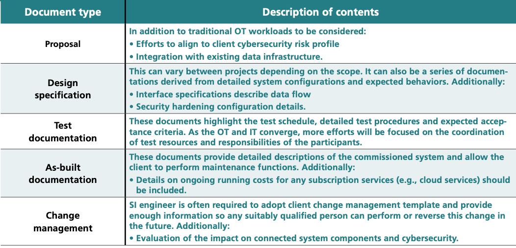

4. Technical writing competency. SI documentation forms a key element in the solution delivery. In the era of rising IT/OT convergence, the increased connectivity between different system components further highlights the importance of documentation details. Stakeholders with varying levels of technical knowledge will consider documentation to be essential in the review and approval process.
Adding cybersecurity considerations in the system adds another dimension to this complexity and makes the technical documentation delivered to potentially form part of the audit trail for compliance purposes. The adoption of cloud computing can enable end users with reduced infrastructure management and higher resilience to abnormal situations. However, the justifications on services selection and the inherent running cost in using the cloud environment require a higher level of technical writing competency to convey the key reasons for the decision making to a nontechnical audience.
For example, Amazon Web Services (AWS) offers more than 200 services in its cloud environment. SI engineers need to precisely document key selection justifications for the adoptions of the required services to allow clients to make informed decisions.
Table 1 indicates a list of common documentation involved in an OT project. SI engineers should be competent and experienced in delivering this documentation for each project required.

Table 1: Common documentations delivered by SI for OT projects. Courtesy: Optimate
