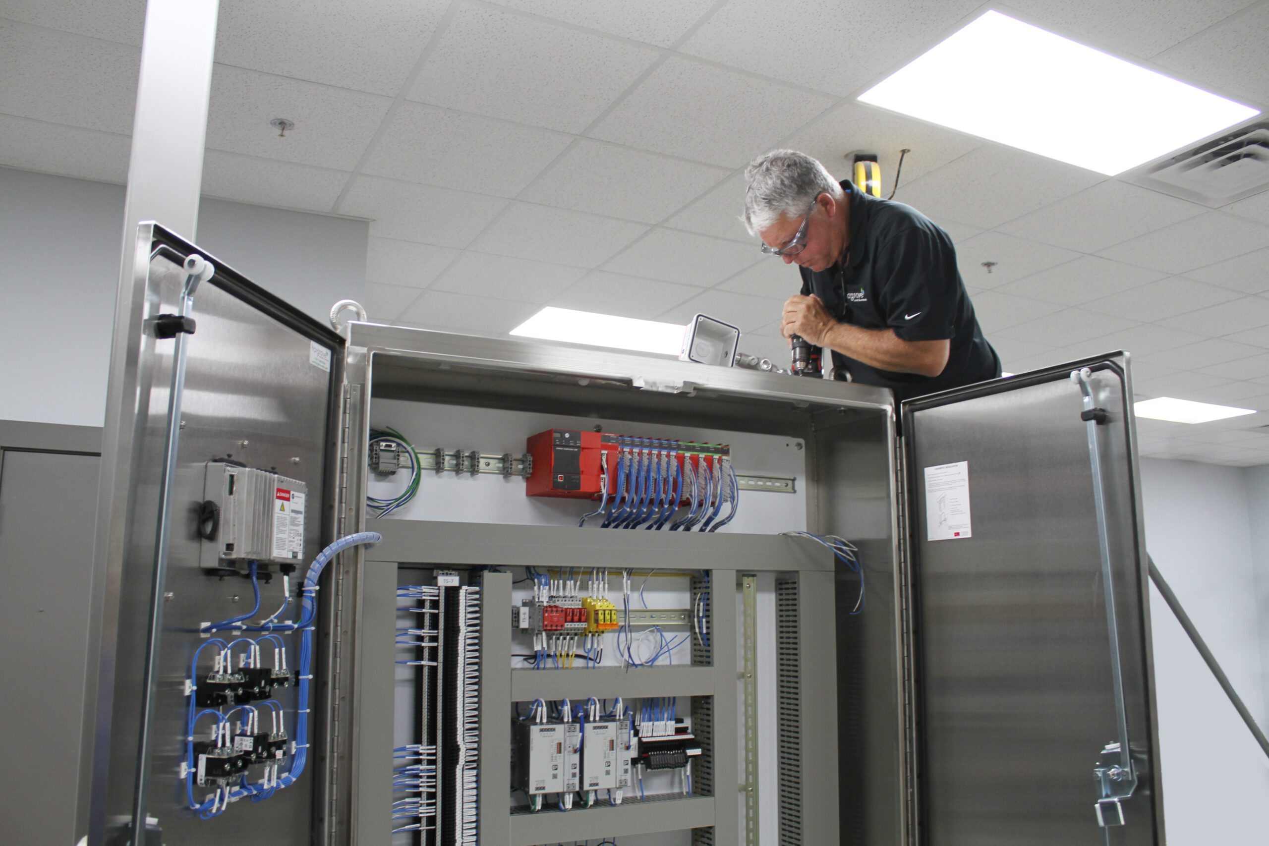

Figure 1: Panel shop technician installs a warning beacon and horn for a petrochemical client. Courtesy: Hargrove Controls & Automation

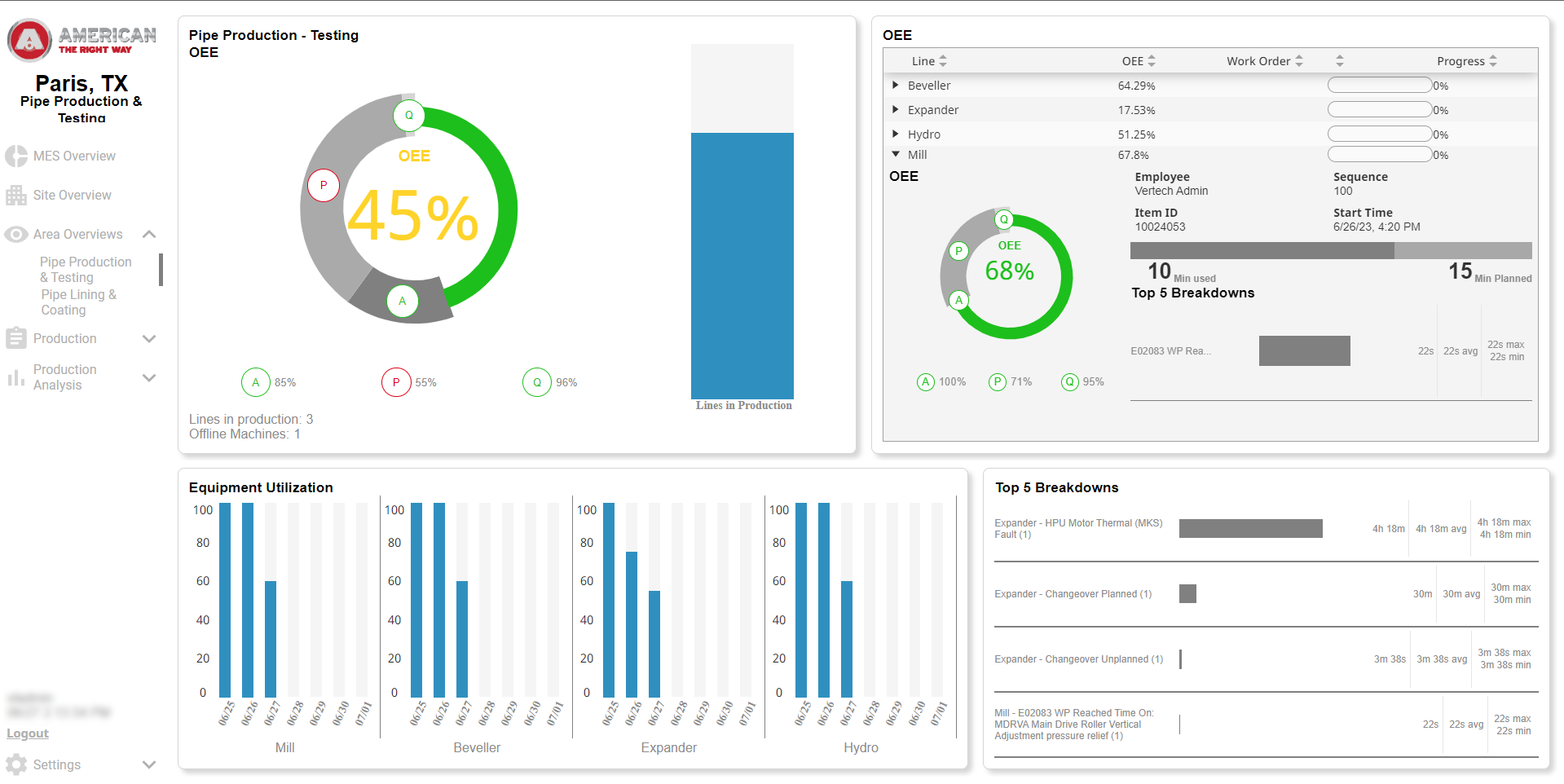

Figure 3: Vertech helped steel pipe maker American SpiralWeld Pipe implement a manufacturing execution system (MES) at its facility to improve operational efficiency and decision-making. Courtesy: Vertech

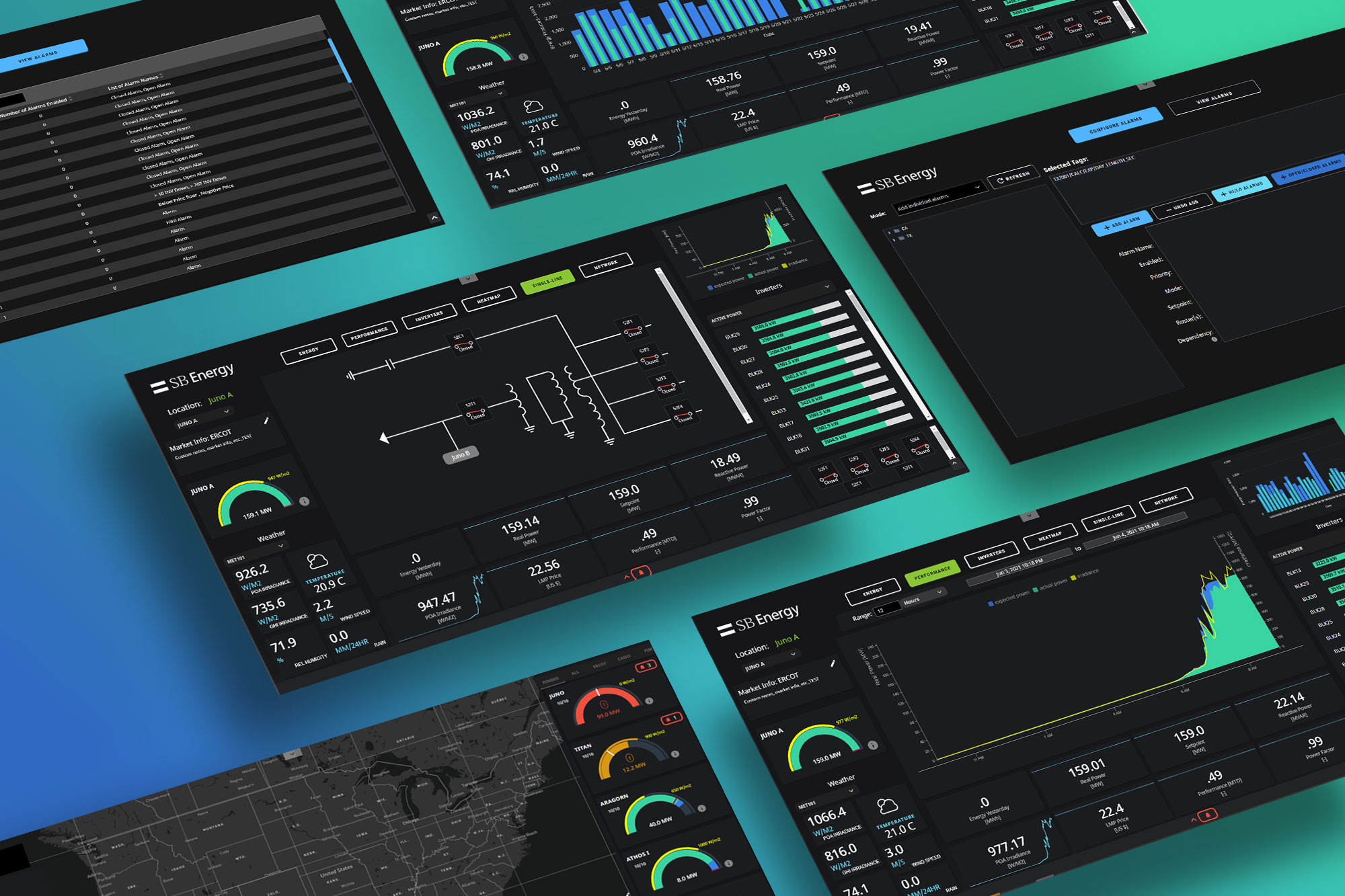

Figure 4: SB Energy engaged Vertech to provide a one-platform SCADA system to remotely oversee six solar sites. Courtesy: Vertech
