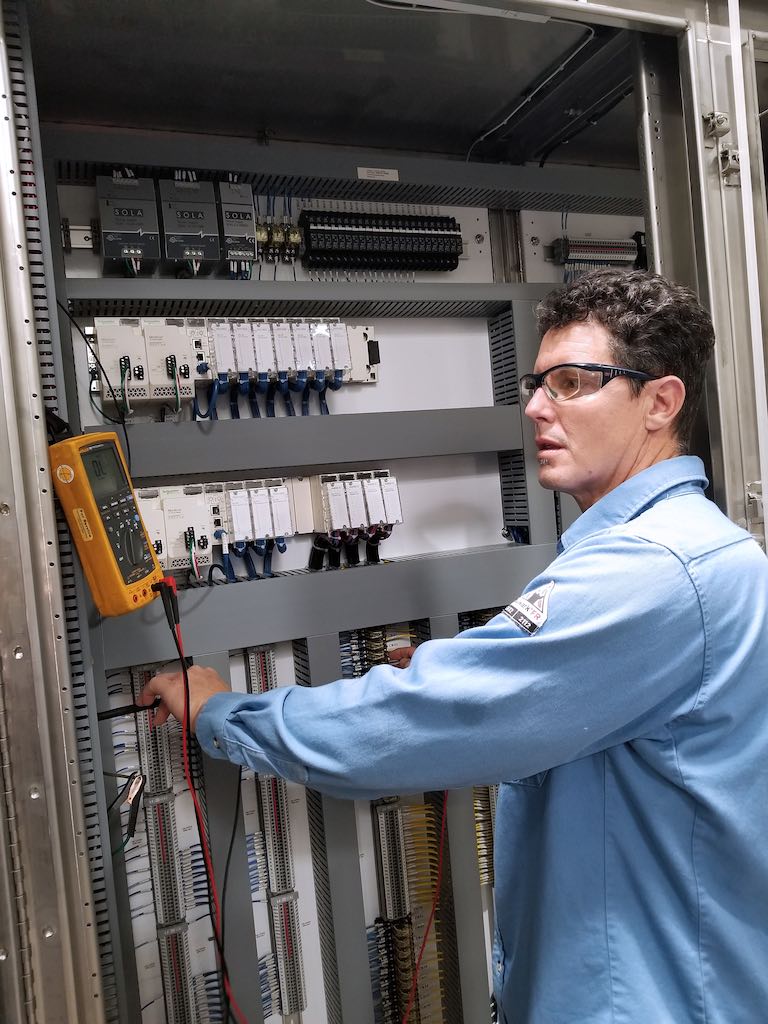

Complete service contracts, which include provisions for SIs to investigate control and electrical panels, can yield significant savings by reducing outages. For example, these investigations frequently identify failed uninterruptable power supplies (UPSs), discover dead PLC backup batteries, and find broken cooling fan and thermostat devices needing replacement to protect equipment from hotter summertime temperatures (Figure 3).
These issues do not always annunciate conditions in ways operators notice ahead of time. However, operators would certainly become aware of the situation in the event of a power failure or heat wave, which can take down system devices and equipment, potentially resulting in downtime, delayed restart time, and program and memory loss.
By engaging a well-versed system integrator from outside the municipality to routinely inspect control panels, facilities can significantly mitigate potential points of failure inhouse operational staff may not notice while focusing on day-to-day issues.

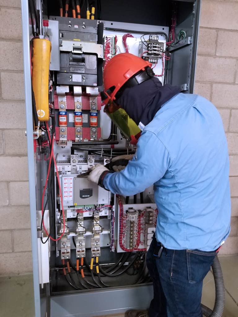

Beyond control panels, some clients choose to have SI support teams inspect electrical equipment, as well. MCCs are industrial-grade electrical hardware, but they are often overlooked by operators who believe that if equipment is running, then all must be well. A prepared SI can scrutinize operational MCCs with voltage and amperage checks, and in some cases use power quality analyzers to identify possible utility power issues (Figure 4).
A thermal imager is another helpful diagnostic device that a municipality might not have on-hand. Thermal imagers are used to perform infrared (IR) scans of electrical components and terminations – MCCs, VFDs, soft starters, contactors, and transformers – while in operation to identify loose connections or failing components. A simple retorquing activity can prevent a lost-time failure event from loose connections.
Infrared scan finds loose electrical connection
For example, an SI was performing IR scans at a municipality as part of its preventative maintenance program, and they found a loose connector on the breaker feeding a VFD. While the VFD was still in operation and appeared to be working normally, the scan showed one of the three conductors on the load side of the breaker was 100 °F hotter than the other two.
The staff was able to safely power down, lockout/tagout (LOTO) the drive, and properly remedy the connection. This solved the temperature issue, preventing operational and safety problems that could have occurred later if not addressed.

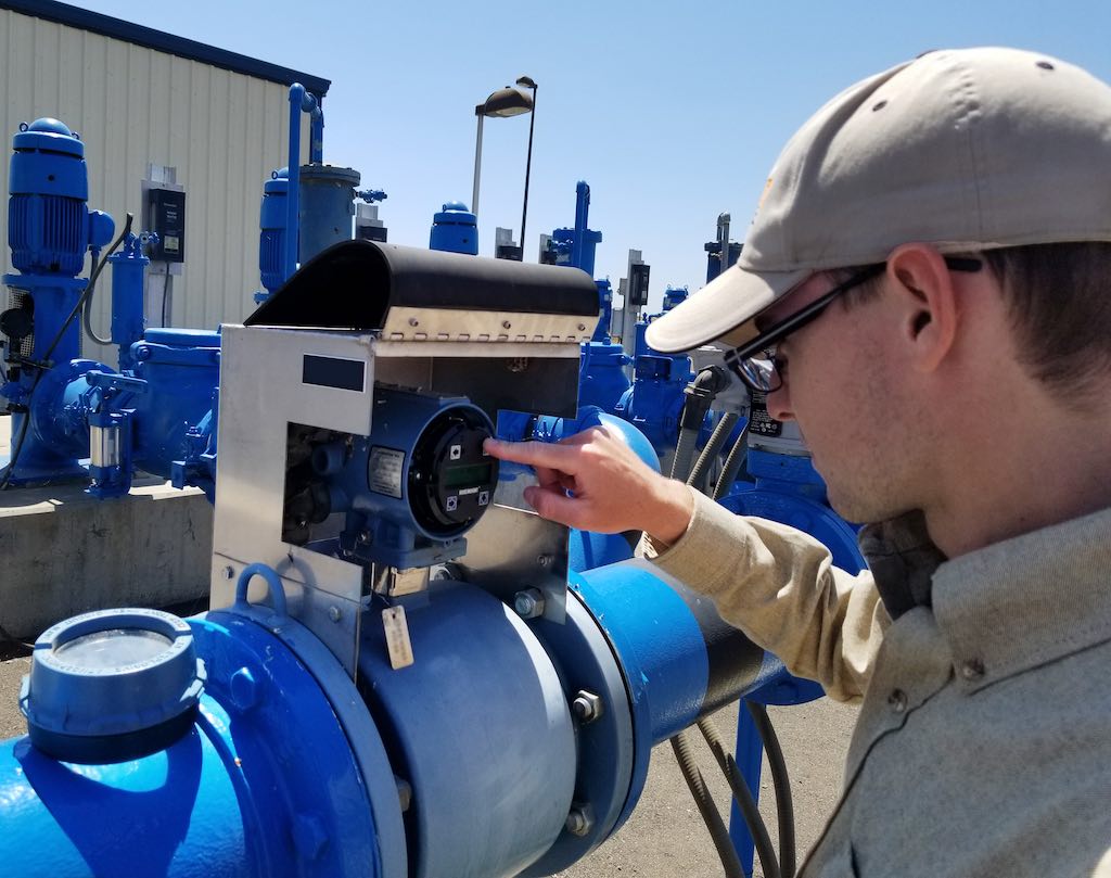

Only some SIs are equipped to perform electrical support services, but a greater number can provide instrument calibration and verification support (Figure 5). Many sites have hundreds or thousands of field instruments of varying vintage, make and model. These often require annual attention to confirm and document proper operation, communication, scaling and interaction with PLCs and SCADA.
While instruments usually are dialed in during startup and commissioning, process and environmental conditions change over time and instrument drift occurs causing errors. If flowmeter was replaced but configured with incorrect scaling, the SCADA system could under-report total process flow.

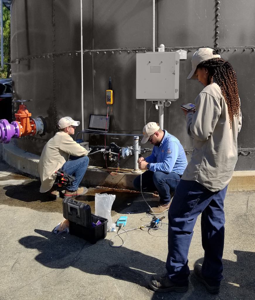

Help with instrument calibration
Many end users would be overwhelmed by ongoing instrument calibration efforts, which is where an SI can provide verification services. This generally consists of tying into each 4-20mA signal loop (or using a HART or Foundation Fieldbus communicator), and simulating the instrument through its scaled range. This requires specially-trained personnel, test equipment and calibration standards.
Trained specialists can work with basic measurements like flow, level, pressure and temperature, as well as advanced analytical technologies. Although water and wastewater staff are often required to be certified in performing analytical calibrations, some regulatory agencies also recommend or require a third-party verification. During these visits, the SI can help identify issues that operators may have missed, such as analyzer tubing degradation, expired reagents and obsolete devices.

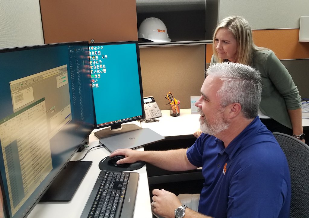

For example, an expanded service contract supporting SCADA maintenance can help identify potential issues with an end user’s computer hardware and software. While a user may believe their system is working well, a qualified SI can scrutinize the hardware’s health in addition to software versions and security vulnerabilities. These proactive efforts may uncover impending hardware failures and potential software issues, giving the client a possible solution prior to catastrophic failure. A reactive response, by contrast would likely involve an expensive, time-consuming and stressful scramble to replace failed elements and restore system software and settings.
SCADA maintenance tasks
A SCADA maintenance service has other benefits. Often, district staff will bring up small issues they have noticed with their SCADA system over the years, and the SI can usually address some of these issues during the normal contractual work (Figure 6).
Perhaps a tag on a display has a maximum value that is clamped too low, below a flowmeter’s actual process value. Or another operator’s phone number needs to be added to an alarm callout roster. These minor issues will not generally warrant a full quote for work to resolve them, but they can be addressed in the scope of preventive maintenance service visits.
SI visits also can act as operational training sessions for operators and other end users. This includes ad-hoc lessons on adding a new trend to a graph, filtering historical alarms and many other navigational and operational details. While SCADA operation instructions are covered during startup and in documentation – such as an operations and maintenance manual – a contracted periodic annual, bi-annual, or even quarterly service visit is an excellent opportunity to refresh operator knowledge, assist newer users and help municipality staff get the most out of their system.
