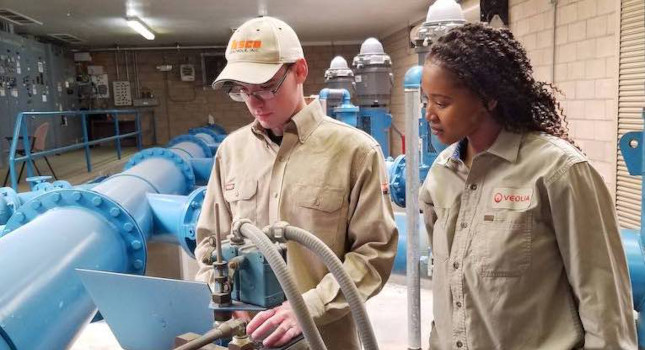

Using packaged equipment supplied by original equipment manufacturers (OEMs) is common in the water/wastewater industry (see Figure 1). OEM equipment, however, can create some specific challenges to the systems integrator (SI) responsible for the automation portion of a project, requiring a strategic approach to drive alignment with other components, systems and standards that may vary from the standard OEM offering. This article explores these challenges and describes strategies to drive success.
