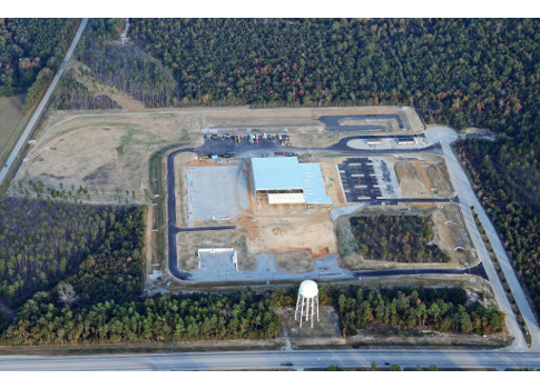

Strategic growth: should you retrofit or build a new facility?
While renovating an existing facility may improve production volume and speed, the facility may not meet the company's long-term needs. It's critical to weigh the pros and cons of both retrofitting and building a new facility.
