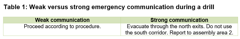

Metric 6: Emergency communication quality
A message was not communicated because it was sent. It was communicated when the right people received it, understood it and acted correctly (see Table 1).
Measure:
Table 1: This compares the difference between a weak and strong emergency communication during a drill. Courtesy: TRADESAFE
  • Time from alarm to first official instruction
  • Message clarity
  • Consistency across supervisors
  • Public address audibility in high-noise areas
  • Radio discipline
  • Text or phone alert delivery
  • Communication to remote areas
  • Language comprehension
Drills should test whether communication works under actual plant conditions: machinery noise, hearing protection, radio congestion, outdoor work, poor reception, shift change and multilingual work groups. The goal is controlled communication.
An acceptable standard should require instructions to be specific, location-based and consistent across PA announcements, radio communication, text alerts and supervisor direction: “Evacuate through the north exits. Do not use the south corridor. Report to assembly area 2.”

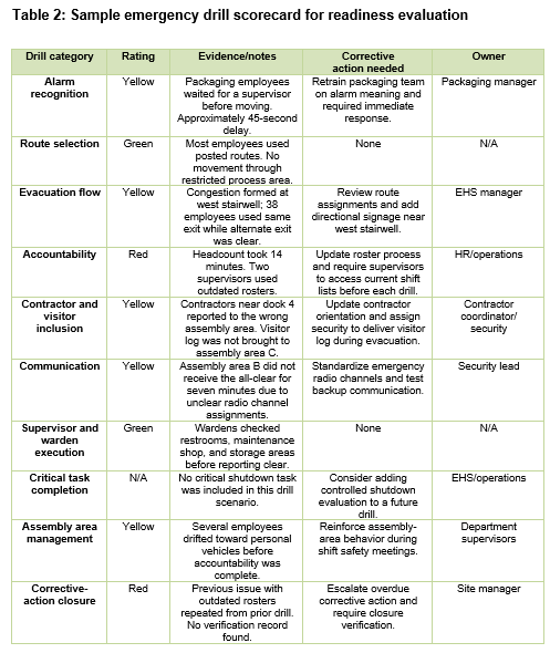

Metric 7: Supervisor execution
Supervisors are often the difference between orderly response and improvised response. Employees may know the route, but supervisors control pace, discipline, sweeps, accountability, escalation and re-entry prevention. If supervisors hesitate, the workforce usually follows that uncertainty.
Measure whether:
Table 2: A sample template of an emergency drill scorecard for readiness evaluation. Courtesy: TRADESAFE

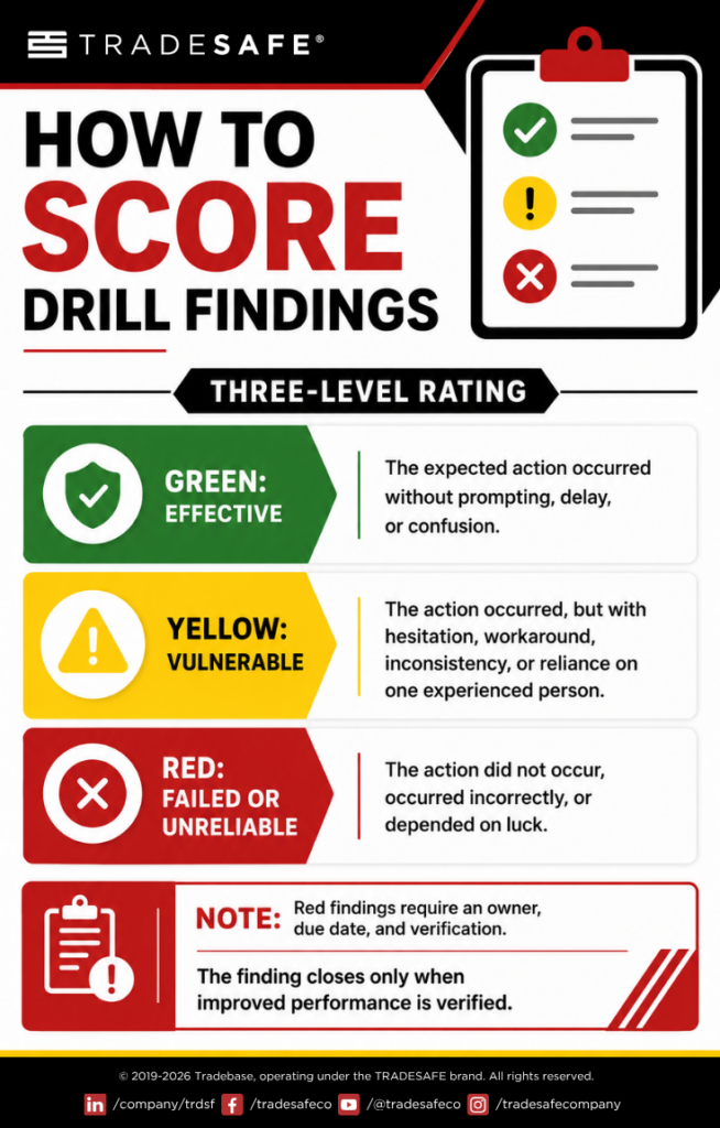

How to build a simple drill scorecard
The categories below follow the core readiness metrics identified in the outline. Use a scorecard before, during and after the drill (see Figure 2).
Red findings require direct ownership, a due date and verification. They should not be closed by saying the topic was “reviewed with employees.” Review may be part of the fix, but the finding is not closed until improved performance is verified.
Figure 2: How to score drill findings using a clear three-level rating system: effective, vulnerable or failed. Courtesy: TRADESAFE
