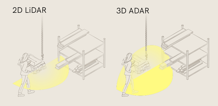

2D LiDAR is typically mounted on the AMR at an 8-inch height. That means it won’t be able to detect feet, so you must add the distance of a foot to your safety. Moreover, there’s a chance that someone could step over 8 inches toward a robot and the robot won’t detect anything before the foot steps down into the zone again.

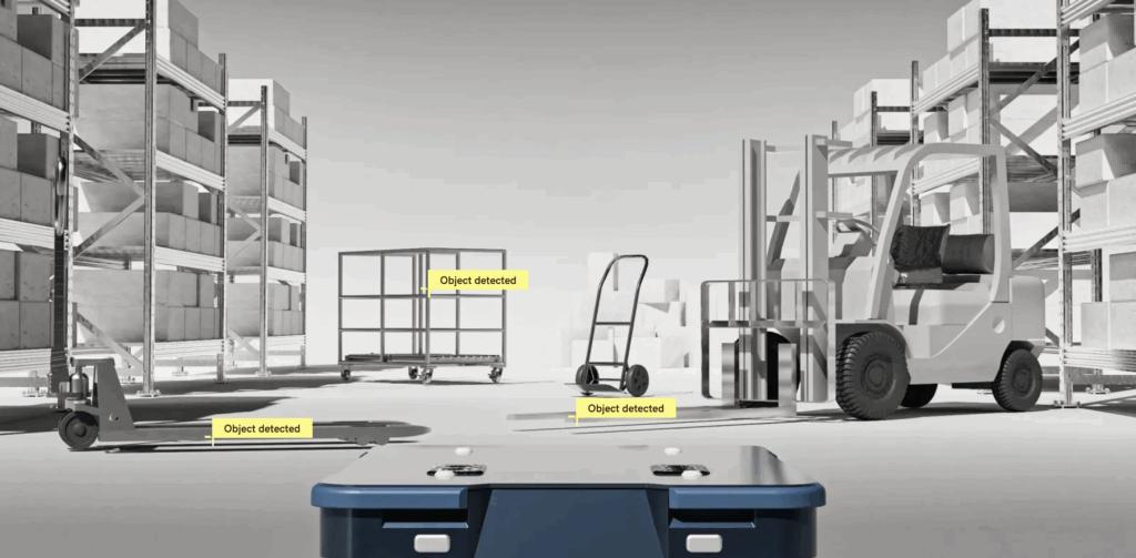

Figure 1: ADAR enables 3D 360-degree obstacle detection around autonomous mobile robots (AMRs) at a lower cost than other sensor packages. Courtesy: Sonair

Figure 2: 2D safety LiDAR are typically mounted on AMRs at a height of around 8 inches and won’t detect objects 4 inches above the floor, objects hanging from the roof or items sticking out from walls or shelves. These limitations present safety risks in dynamic environments. Courtesy: Sonair

This 3D ultrasonic sensor has potentially massive implications for AMR design and safety. A single ADAR sensor can provide a 180×180-degree field of view and a 16.4-foot range for safety functions. Unlike traditional 2D LiDAR sensors, ADAR-based sensors can detect overhangs, protrusions and low-lying obstacles effectively. ADAR doesn’t struggle with transparent surfaces. In effect, the sensor establishes a 3D safety shield for obstacle detection around any mobile robot.
