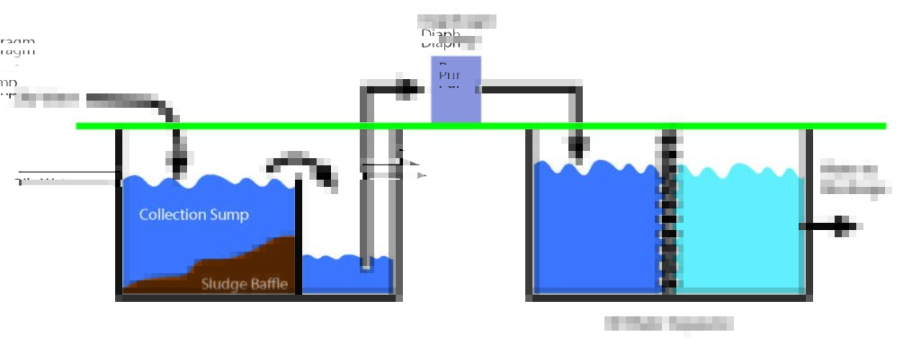

Secondary containment, if available, can dramatically reduce risk. A site designed so spilled oil or product flows into an oil-water separator, controlled collection pit or contained process area has more time to respond and fewer pathways to the environment. Facilities without secondary containment should identify the most likely flow paths and stage spill materials at those locations.
