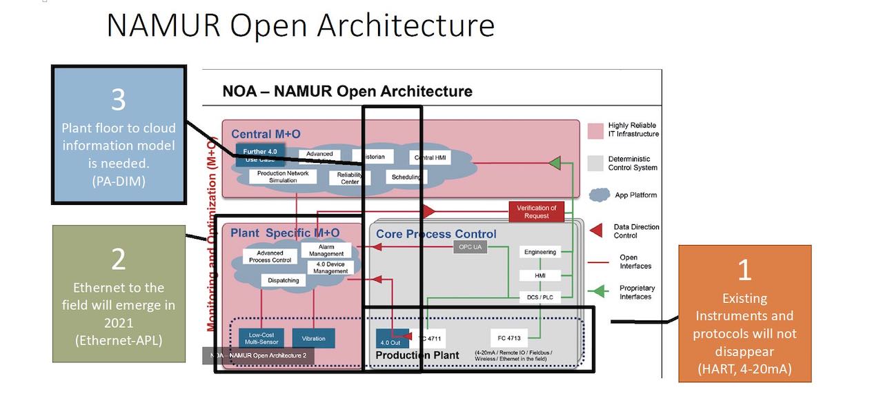

FieldComm Group (FCG) is closely aligned with the Namur Open Architecture (NOA) as a means of digitalization since it does not disrupt existing systems and provides a path for migrating users to a digitalized approach. NAMUR is the User Association of Automation Technology in Process Industries.
Process automation open architecture
The NAMUR open architecture proposes future process automation facilities will:
1. Continue to use existing instrumentation protocols
2. Make use of new high-speed and IP based physical layers
3. Take advantage of simplified integration tools to move plant floor data throughout the global enterprise
4. Use one-way communications out of the core process control domain to reduce cybersecurity threats.
Namur Open Architecture provides an approach for using field devices supporting OPC UA (OPC Foundation) as the data exchange technology. Working jointly with OPC Foundation, FCG has developed a new OPC UA based standard to replicate the most common set of field device parameters in process instruments. The technology is called PA-DIM (process automation device information model). PA-DIM adds specificity to the standard OPC UA device information specification and defines core parameters to establish a standard set of data for each class of process automation device. PA-DIM also delivers these parameters in machine-readable format enabling use by applications, independent of the supplier or protocol that delivers it.
