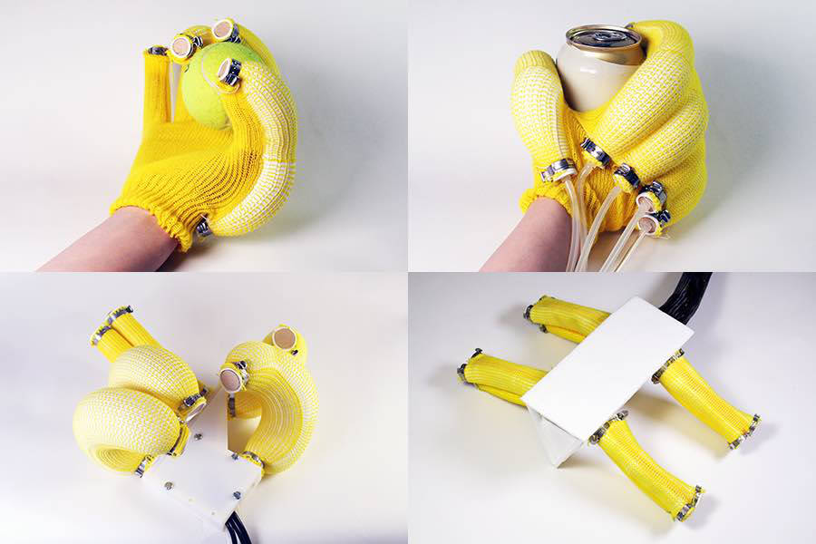

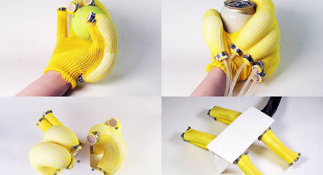

Scientists from MIT’s Computer Science and Artificial Intelligence Laboratory (CSAIL) devised a scalable pipeline to computationally design and digitally fabricate soft pneumatic actuators, called “PneuAct.”
Wearable assistive robotics with integrated sensing. Courtesy: MIT CSAIL
PneuAct uses a machine knitting process — not dissimilar to your grandma’s plastic needle knitting — but this machine operates autonomously. A human designer simply specifies the stitch and sensor design patterns in software to program how the actuator will move, and it can then be simulated before printing. The textile piece is fabricated by the knitting machine, which can be fixed to an inexpensive, off-the-shelf rubber silicone tube to complete the actuator.
The knitted actuator integrates conductive yarn for sensing, allowing the actuators to “feel” what they touch. The team cooked up several prototypes spanning an assistive glove, a soft hand, an interactive robot, and a pneumatic walking quadruped. Their devices were wrapped in a soft, yellow fabric that made them look a little bit like banana fingers.
While there’s been plenty of movement in the hardware development of soft pneumatic actuators over the years — a 2019 prototype of a collaborative robot used such actuators to reproduce human-like gripping in its hands — the design tools haven’t improved with quite as much speed. Old processes have typically used polymers and molding, but the scientists used a combination of elastic and sensing stitches (with conductive yarn) that allows for programming bending of the devices when they’re inflated, and the ability to incorporate real world feedback.
For example, the team used the actuators to build a robot that sensed when it was touched specifically by human hands, and reacted to that touch.
The team’s glove can be worn by a human to supplement finger muscle movement, minimizing the amount of muscle activity needed to complete tasks and motions. This could hold a lot of potential for those with injury, limited mobility, or other trauma to the fingers. The method can also be used to make an exoskeleton (wearable robotic units controlled by a computer that supplement human motion and restore locomotion and movement); to that end the researchers made a sleeve that can help wearers bend their elbow, knee, or other body parts.
“Digital machine knitting, which is a very common manufacturing method in today’s textile industry, enables ‘printing’ a design in one go, which makes it much more scalable,” says Yiyue Luo, MIT CSAIL PhD student and lead author of a new paper about the research. “Soft pneumatic actuators are intrinsically compliant and flexible, and combined with intelligent materials, they’ve become a necessary force in many robots and assistive technologies — and rapid fabrication, with our design tool, can hopefully increase ease and ubiquity.”
MIT scientists created a rapid design and fabrication tool, and created machine-knitted pneumatic actuators: an assistive glove, a soft hand, and a pneumatic quadrupedal robot. Courtesy: MIT CSAIL
