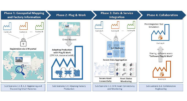

There are four phases in the testbed:
  • Phase 1: Geospatial mapping and factory information
  • Phase 2: Plug and work
  • Phase 3: Data and service integration
  • Phase 4: Collaboration
  • Phase 5: Eco-system development
The testbed’s architecture and experiences gained in the testbed over all phases will be documented in a technical design report to be published as a whitepaper in 2019. The testbed team plans to extend the report to describe the work being done in the Digital Twin/PI4.0 Component testbed, a project under the IIC-PI4.0 Joint Task Group and on data sovereignty following the concepts of the International Data Spaces Architecture.
The first three phases have been completed up through the data and service integration. Phase 4 involves the collaborative software engineering of these systems and overlaps with Phase 5 covering cooperative projects with other initiatives. There is on-going work on the overall system architecture to include new developments with the Asset Administration Shell, as well as extensions of the testbed to support the Negotiation Automation Platform from NEC. Currently, the collaborative software engineering phase is ongoing — intensifying the work on the Asset Administration Shell, on the extension of the Smart Factory Web platform for other testbeds, and for the work with IDSA.
The technical report highlights the description of assets in AutomationML, covering:
  • Their capabilities based on an ontology (to discover and integrate them as resources in a factory or supply chain),
  • The definition of data to be sent to Smart Factory Web and Microsoft Azure through OPC UA or SensorThings API and
  • The visualization of asset data in Smart Factory Web and Microsoft Azure.
Phase 4 focuses on collaborating to achieve the necessary software engineering to integrate factories, and therefore requires the engineers and assets in the factories to provide data and semantics of the assets in a way that can be integrated into a cloud—Smart Factory Web or Microsoft Azure.
