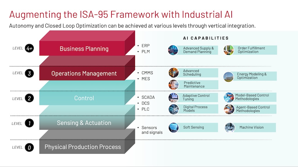

Mithun Nagabhairava: Enabled by the latest technological advancements, manufacturers are leveraging AI/ML to solve their complex production challenges and establishing autonomous capabilities. While an automation system is explicitly programmed to perform tasks in the absence of human intervention, an autonomous system can learn how to perform tasks on its own and even adapt to changes in a process or environment. Put simply, the autonomous system replicates the cognitive ability of humans to learn, make decisions, take action against those decisions and improve.
For instance, in a manufacturing process, the model may sense that a critical process parameter is drifting above or below an ideal set point. Based on learnings from what causes this variation and what actions can solve it, the model can evaluate a very large array of possible actions to take and recommend the action that will drive the best outcome.
