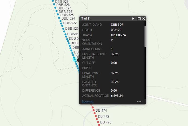

Figure 1: Adding data to a visualization tool gives utility owners the ability to verify data, for example joint locations. Courtesy: Dewberry

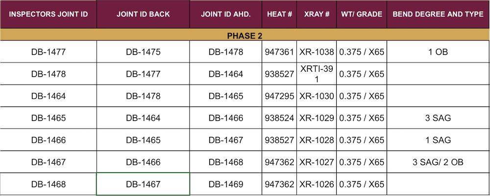

Table 1: Raw data can be displayed in a spreadsheet, allowing utility owners to see detailed elements of their systems. Courtesy: Dewberry

A valuable means for fostering continual communication during a recently completed 16-mile, 24-inch diameter, high-pressure transmission line was a digital map-based management tool that tied considerable amounts of TVC data with visual representations of the pipeline asset as construction and commissioning progressed. The tool was structured so that users could access multiple levels of data in real time, tracking changes and updates as they occurred.
In addition to bridging diverse experience and approaches, complementing TVC data with visual representations enhanced teamwide understanding that the documentation process was not merely an exercise in collecting discrete pieces of information, but rather an interconnectedness of activities.
