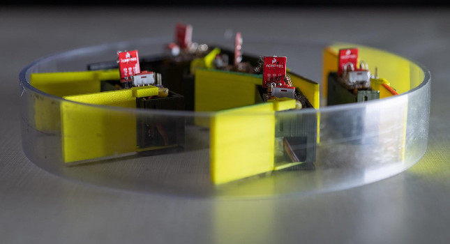

The 3-D-printed smarticles — short for smart active particles — can do one thing: flap their two arms. But when five of these smarticles are confined in a circle, they begin to nudge one another, forming a robophysical system known as a “supersmarticle” that can move by itself. Adding a light or sound sensor allows the supersmarticle to move in response to the stimulus — and even be controlled well enough to navigate a maze.

Light hitting a smarticle (smart active particle) causes it to stop moving, while the other smarticles continue to flap their arms. The resulting interactions produce movement toward the stopped smarticle, providing control that doesn’t depend on computer algorithms. Courtesy: Rob Felt, Georgia Tech[/caption]
