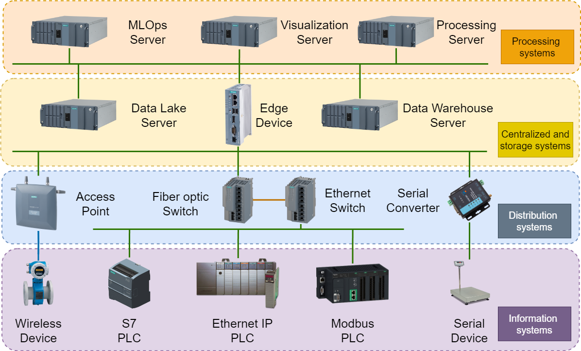

2. Identify the information sources
The information can come from various sources, from simple control systems using programmable logic controllers (PLCs), as well as more complex and interconnected systems such as supervisory control and data acquisition (SCADA) systems, servers, external applications, manual signal acquisition and more.
It also is very important to identify the source, data type and frequency. Also in many cases, the information needed is non-existent, so it is necessary to install sensors and previous processes to acquire such data. These systems are known as “information systems.”
3. Identify extraction protocols
Each system has its own communication protocol, so it is important to consider an intermediate point between the “information systems” and the “centralized system” for later on. In the past, for different technological and commercial reasons, it was customary for companies to have their own communication protocols, and therefore these protocols were not compatible with devices of another brand or manufacturer.
This led to the need to have only devices of the same brand or manufacturer. However, over the years, companies have reached agreements to use universal protocols, which has greatly favored the interconnection of systems.
In order to achieve a correct interconnection between systems, the objective must be to unify all serial protocols to universal network protocols, so their extraction is simple and homogeneous. For this purpose, additional equipment, such as protocol converters, must be considered for cases where the system cannot do it natively.
The physical media that will be used to transmit the information, such as fiber optic copper cabling or the use of radio frequency, must also be considered. Currently, in an architecture for industrial systems, the OPC UA output protocol allows a correct interconnection between systems.
4. Selecting the right edge device
The edge device is the device in charge of centralizing, transforming, and cleaning the information obtained from the “information systems.” To this end, it must be able to communicate in the communication protocols previously identified, as well as having the necessary ports to physically interconnect to the networks.
In general, it must be connected through an Ethernet port to the operational technology (OT) network and through another port to the information technology (IT) network. Depending on the number of variables and the communication protocols, the hardware and operating system capacity must be selected.
The edge device can be either the “centralized system” or the “storage system” if it has the necessary resources. However, it is recommended the “centralized or storage system” be a dedicated server for information storage and processing. Therefore, the edge device serves as extract transform load (ETL) for the “centralized system.”
5. Create interconnection topology
Once the elements containing the information have been identified, the next step is to develop the topology that will allow all systems to communicate to a centralized system. Allowing the extraction of the information for further processing.
It is important to remember that, if necessary, installing additional equipment to change the serial communication protocols to the network, the installation of switches to distribute the network, as well as fiber optics converters to interconnect the systems over long distances, among other infrastructure and network equipment, should be considered.
Do not forget to check in detail the configuration of the equipment to avoid issues of duplicity of IPs, mac address, incompatibility problems and cybersecurity. This set of tools and devices is known as the distribution system.
6. Centralize the information
Having the topology in place, it is possible to start with the extraction of information from the “information systems” and centralize the data in one or several “storage systems.” For example, each area could have its own centralized system or storage and at the same time have another one at a higher level that centralizes the summarized information of each area. With the intention of having information at a local level focused on the plant and at a global level focused on the management of the organization.
Once all the infrastructure is in place to extract the information, the next step is to organize it in a way that facilitates subsequent analysis.
