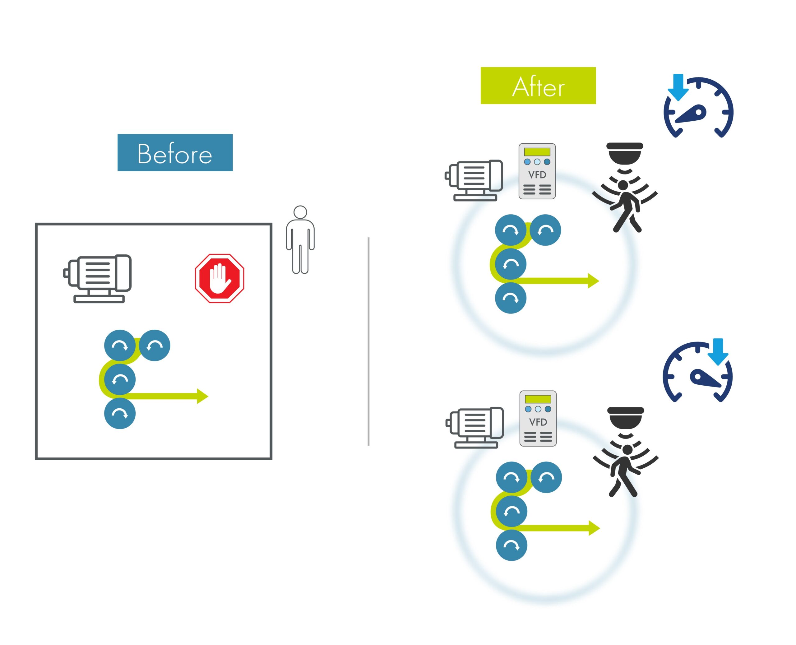

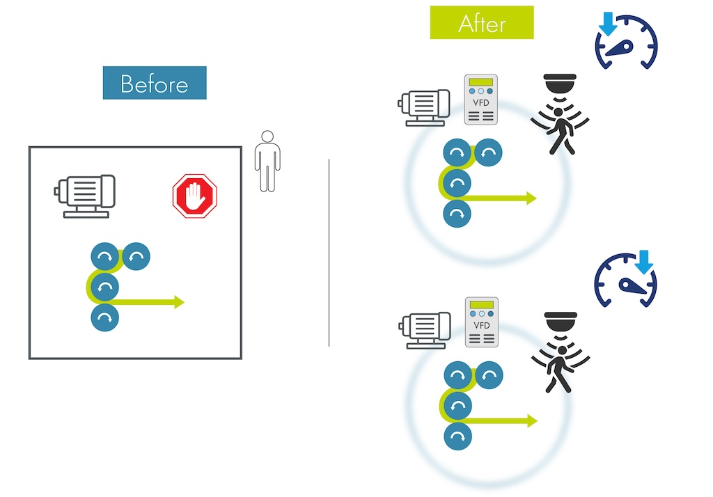

Example 1: A safety VFD controls a calendar machine, minimizing downtime and eliminating fencing.
A tire company recently improved the productivity of a large calendar machine using the safe limited speed feature of a safety VFD. The design also eliminated the need for safety fencing, therefore reducing its overall footprint.
The calendar machine was originally driven by a motor without a VFD and had a large fenced-off area surrounding it to maintain safety. Personnel were prohibited unless they requested entry, which then required a full power down of the system. Additionally, the system’s restarting process was lengthy, resulting in significant downtime whenever someone needed access to the equipment.
Using the safe limited speed feature of a safety VFD, a more flexible safety solution for the calendar machine was designed and implemented. If the calendar machine could always be stopped such that an individual within its proximity would never be injured, then safety fencing would not be required (see Figure 1).
Figure 1: The effect of a variable frequency drive (VFD) on a calendar machine versus a standard motor, resulting in reduced downtime. Courtesy: Hargrove Controls & Automation
The safe speed of operation was therefore defined dynamically, based on the current proximity of personnel to the machinery. Production could continue at reduced rates as defined by the proximity of personnel to the machine and its stopping time based on its current speed of operation. A proximity detection sensor was implemented so that a person’s distance from the hazard could be continuously monitored.
As an individual approaches the machine, the safe limited speed quantity is reduced to allow sufficient stopping time if this individual begins running toward it. Once an individual is sufficiently close, the machine stops entirely. As an individual moved away from the machine, the machine safety returned to production speed.
By allowing the equipment to run at reduced speeds in the presence of personnel, this setup minimized downtime therefore increasing overall productivity. In addition, the need for physical barriers was eliminated, freeing up floor space.
