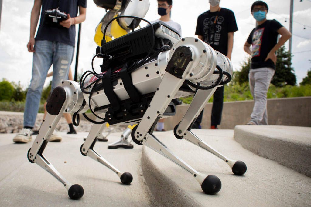

A Mini-Cheetah robot at The University of Michigan. Courtesy: Robert Coelius, Michigan Engineering

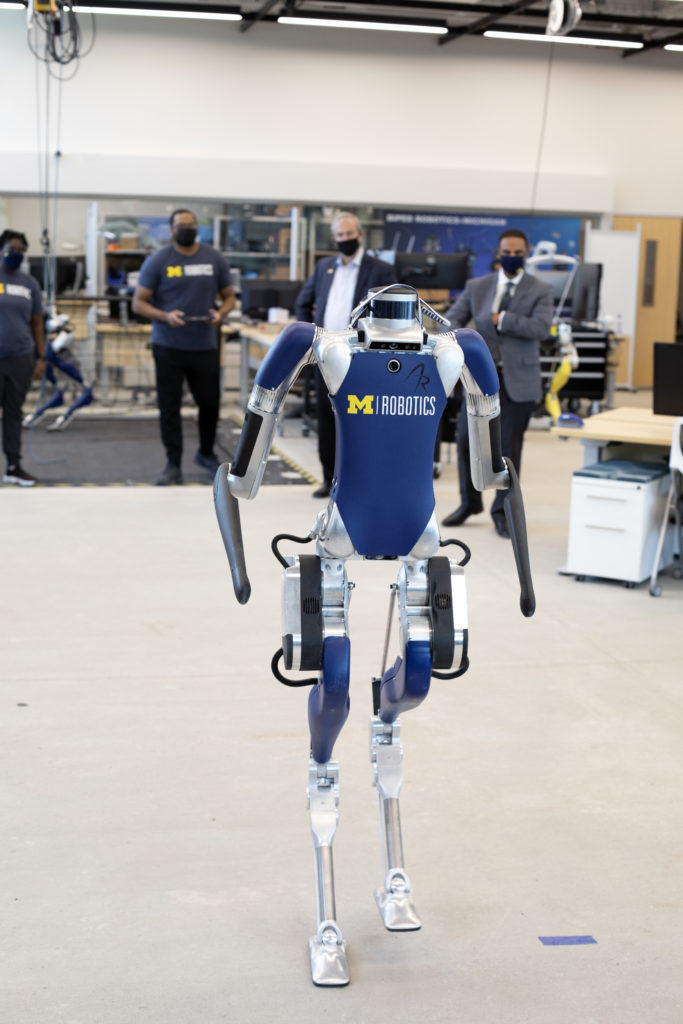

A Digit robot at The University of Michigan. Courtesy: Joseph Xu, Michigan Engineering
