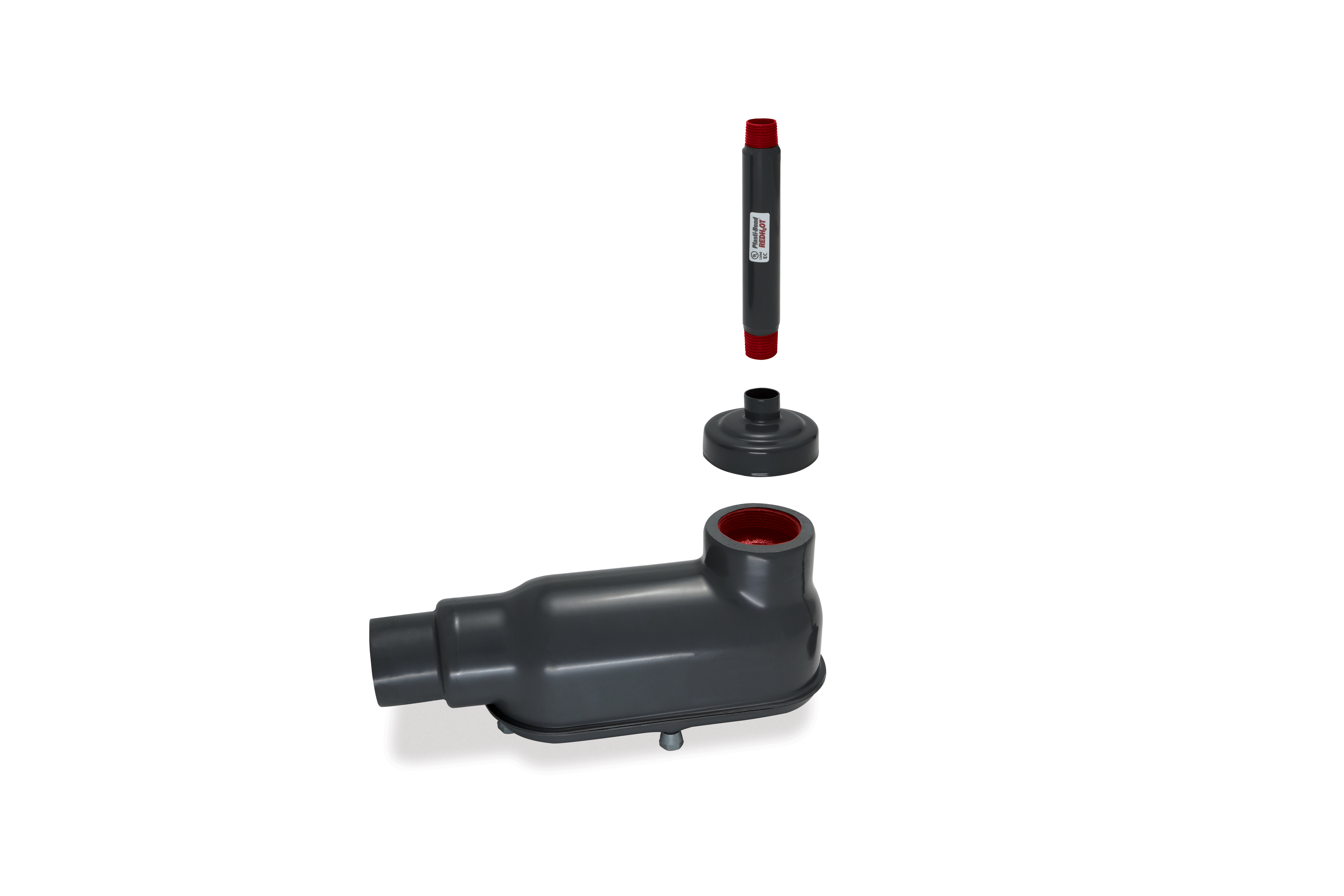

Introducing our patent-pending PVC coated reducing bushings with sealing sleeves – an innovative solution for threaded rigid conduit raceway systems. Designed to address the challenges of connecting larger trade size PVC coated conduit bodies to smaller conduits, these reducing bushings redefine the standards of connection integrity and protection against moisture ingress and crevice corrosion.
The reducing bushings feature an integrally molded connection ring that snugly fits over the female conduit entry, ensuring a tight and secure seal at connection points. The integral PVC sealing sleeve on the reducing bushing enhances the overall performance of the system, significantly reducing the risk of moisture ingress and damage caused by crevice corrosion. Available in trade sizes ranging from ½ inch through 2 inch, our reducing bushings come in 15 different configurations, aligning perfectly with diverse customer requirements. The integral bushing within the reducing bushing not only facilitates smooth pulling but also provides an additional layer of protection against conductor damage, ensuring the longevity and reliability of your electrical systems. Manufactured using UL listed PVC material, our reducing bushings adhere to industry standards, guaranteeing a high-quality and reliable solution for your conduit raceway systems.
