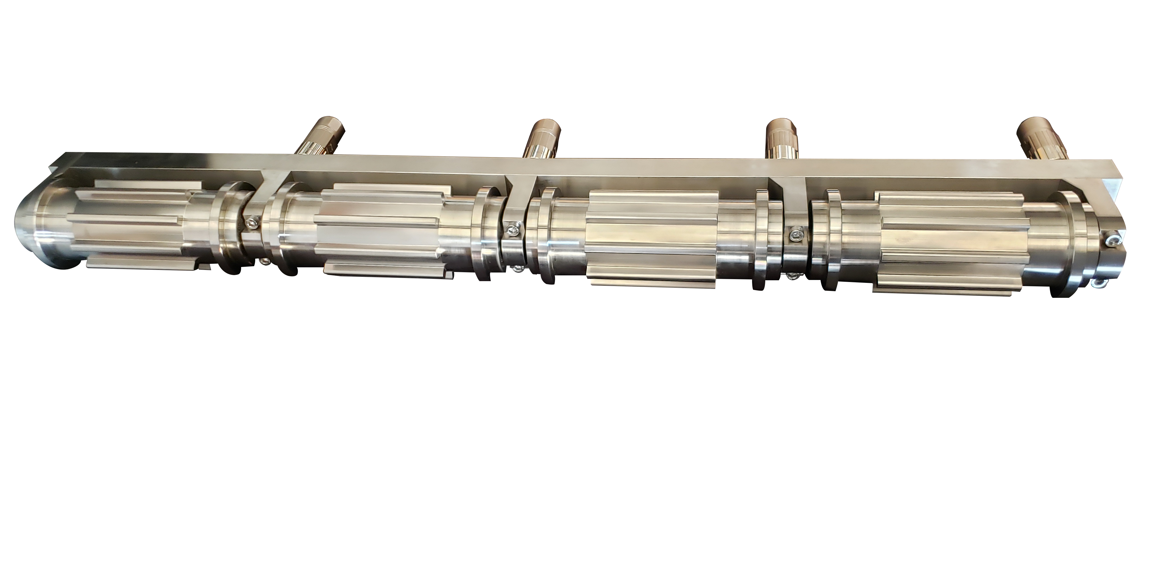

The Multi-DriveTM by One MotionTM provides unique advantages not previously available in the packaging automation industry. It allows automation equipment manufacturers to place multiple conveyors side-by-side with minimum belt separation. This arrangement is accomplished without the need to design complex power transmission components that get buried underneath the conveyors. Conventional four belt systems make repairs and maintenance difficult and are not easy to clean. The Multi-DriveTM can run two, three, or as many as six belt rollers on a single shaft, with as little as just a few millimeters of separation between the conveyor pulleys. When integrating Multi-DriveTM powered pulleys in a multi-conveyor system, each conveyor can be run separately and completely independent from the other conveyors mounted on the same shaft, regardless of how close they are to each other.
