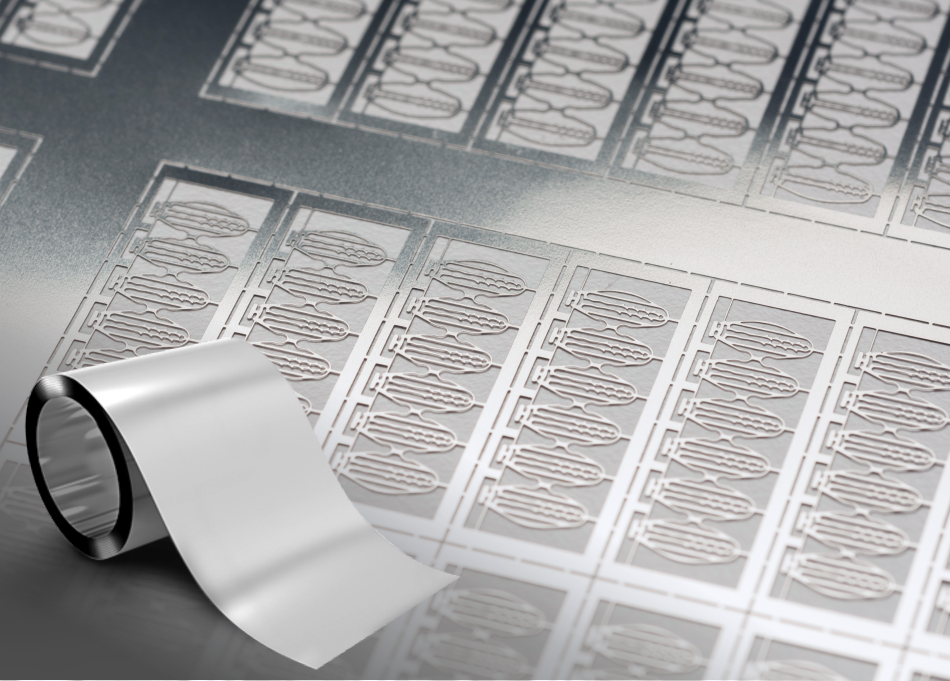

As wide as 17.5” and as thin as 2µm (0.00008”) with controlled, consistent quality
Rochester, NY: Arnold Magnetic Technologies Corporation (“Arnold”), a subsidiary of Compass Diversified (NYSE: CODI) and leading global manufacturer of high-performance magnets, magnetic assemblies, precision thin metals and highly loaded composites, announces its range of titanium foils and alloys. Arnold offers thin cold-rolled titanium in a variety of CP Grades and alloys and an exceptionally broad range of thicknesses and widths for many vehicle-related applications that require a strong, lightweight, corrosion-resistant material that is highly workable, ductile, and weldable. As the global leader in ultra-thin cold-rolled metal strip and foil, Arnold achieves unmatched thinness while maintaining controlled, consistent mechanical and physical quality. Arnold’s “Ultra Thin Gauge” foil is available in thickness down to 2 µm (0.00008“), in addition to the “Thin Gauge” options (0.020” – 0.0005“). Widths are available up to 17.5”, depending on thickness. For example, foil 0.0029” – 0.001” thick has a maximum width of 16.5”. Widths as narrow as 0.031” can be achieved through slitting. Arnold offers multiple Commercially Pure (CP) grades with 99%+ pure titanium. Options include Grade 1 which has the highest purity of commercially available titanium with excellent corrosion resistance to chlorides, and Grade 2, the most commonly specified grade of CP titanium, which has good ductility .
