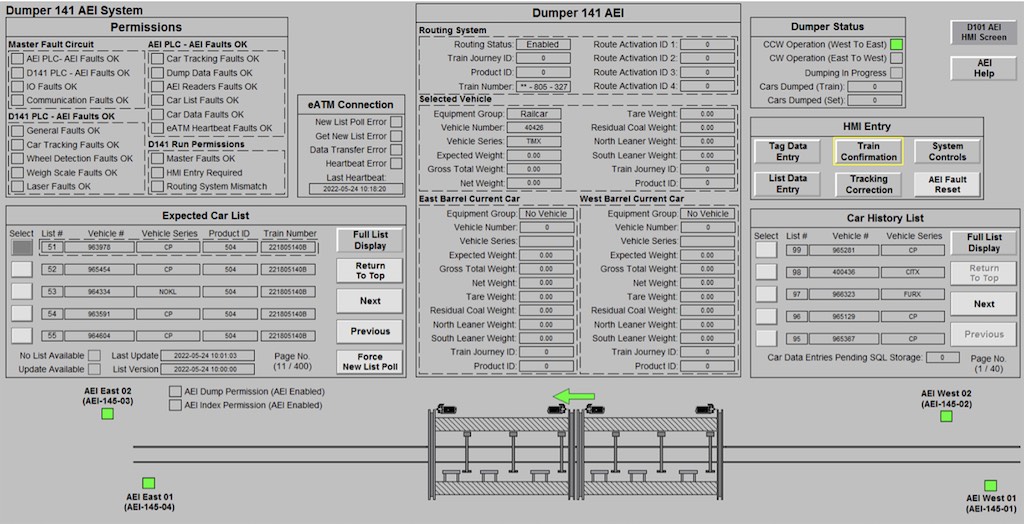

Figure 1: The main routing interface, which shows most of the routing information transacted to the SQL database. Courtesy: Softing

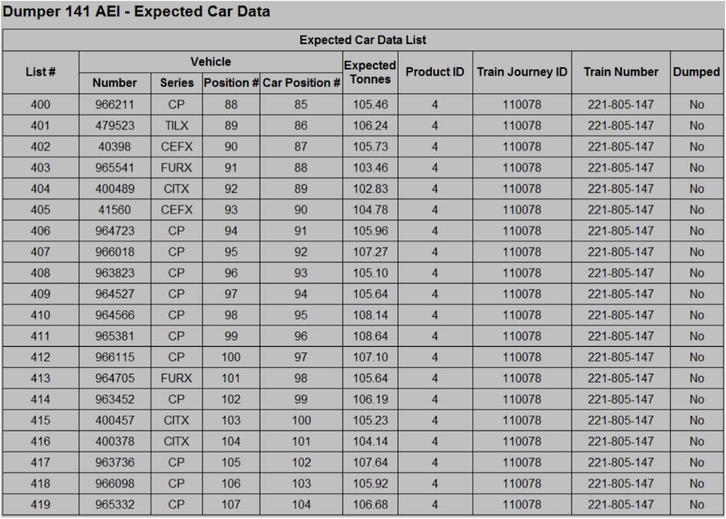

Figure 2: Dumper Automatic Equipment Identification (AEI) graphic showing the data transacted to and from the PCS database to the PLC. Courtesy: Softing

Figure 3: The SQL sends an expected car list to the respective PLCs. When a coal railcar enters the dumper, it is read by the AEI readers and matched with the car details from the expected car list. Once dumped, the actual production data for that railcar is sent to the PCS database using tManager. Courtesy: Softing

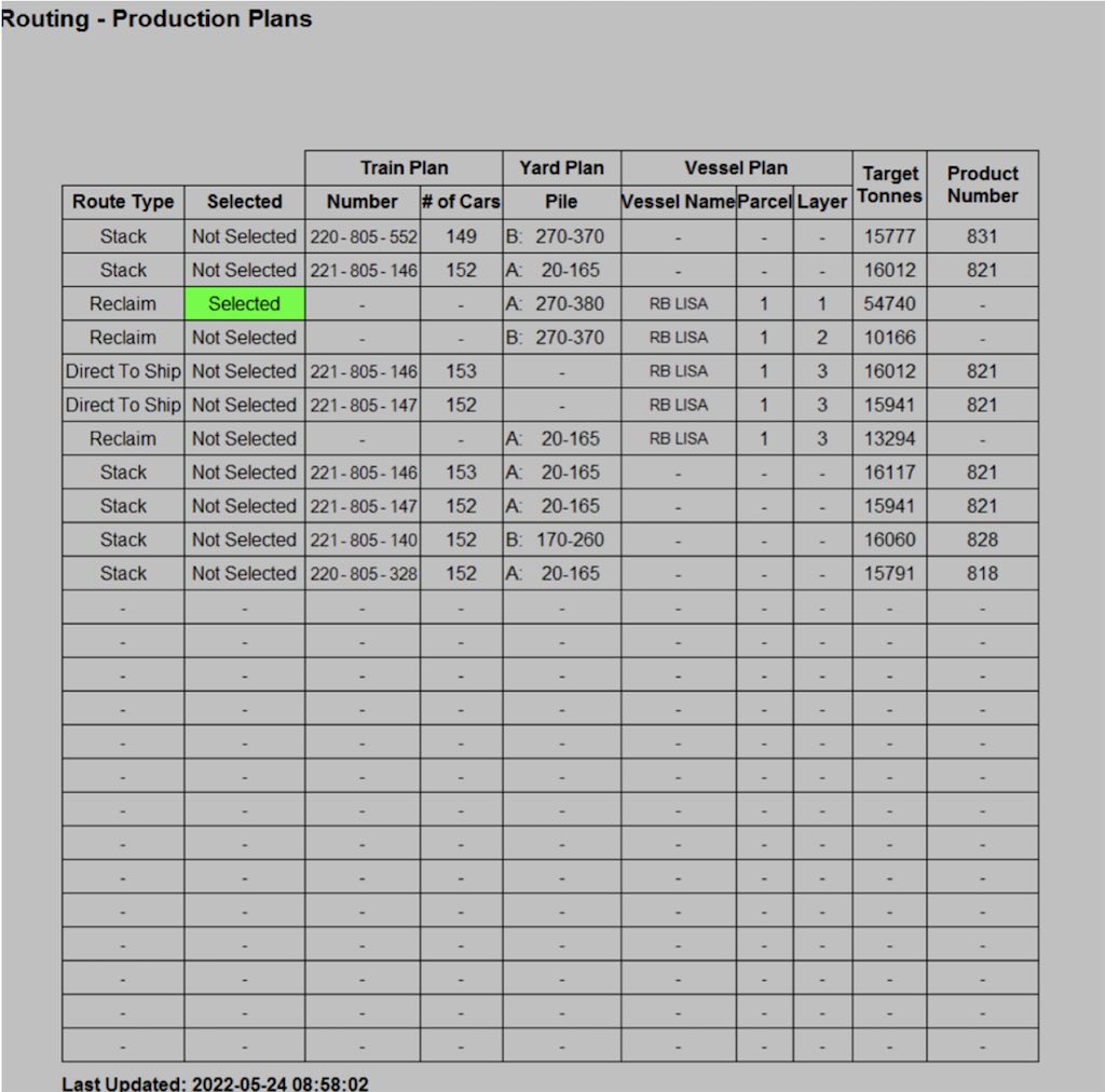

Figure 4: Production plans received from the SQL to the PCS, showing the defined source-to-destination plans that the routing system ties to a running route. Courtesy: Softing
