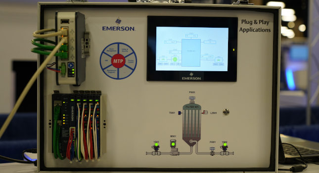

Industry standards such as NAMUR module type packages (MTP) have been instrumental in elevating the concept of modularized and encapsulated systems (Figure 3). MTP identifies certain aspects of automation and indicates how they are exposed for interactions with outside or supervisory systems. When MTP-based automated equipment is attached to a supervisory system, the system can understand the equipment as a functional machine object.
MTP provides a way for developers to identify and define the available equipment functionality, and how to invoke it. All the necessary data tags are exposed in context for commanding, monitoring, alarming, and diagnosing the subsystem. Even the HMI displays can be developed by the subsystem supplier and imported into the supervisory system.
A machine configured using MTP may contain significant logic and data tags for internal use. However, a supervisory system can access just what is needed for high-level operation. For instance, a packaged PLC-controlled mixing tank subsystem could be integrated with a supervisory system using MTP. The supervisory system could call for fill, mix, and drain cycles. The machine’s automation system would then handle the details of timing, opening and closing valves, operating the mixer, and generating status and alarm tags.
