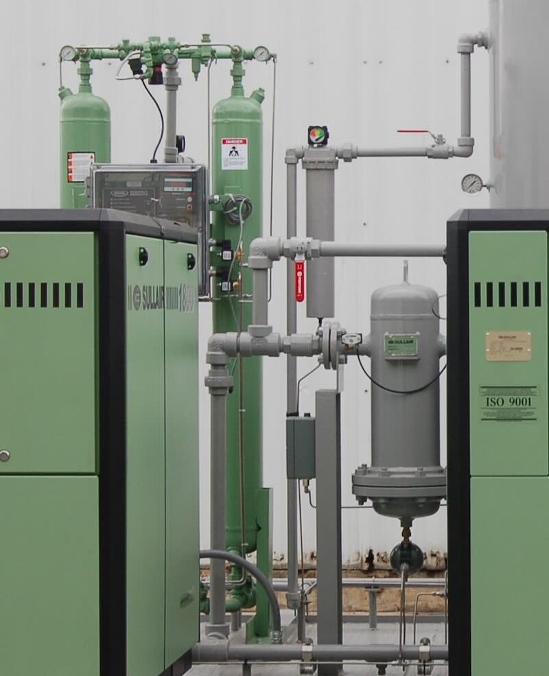

Piping is a compressed air conduit
Pipes are the conduits that carry the compressed air to the process once it leaves the compressor. All compressors come with a discharge pipe connection sized by the manufacturer to have the proper and minimal pressure drop for the best compressor operation. Added to this connection is a manual (or automatic) shut-off valve. This disconnects the compressor from the compressed air system in times of maintenance.
The system piping to the plant after the shut-off valve, needs to be at least the size of the discharge connection at the compressor. The size of the pipe at the discharge of the compressor should never be reduced. Increasing the pipe size, however, is often beneficial to a compressed air system from a control reliability standpoint. The piping should also have the least number of 90° elbows as possible. In a good installation, sweeping piping radius bends are the best solution. This helps reduce the pressure drop every 90° elbow affords. As the piping connects to the main header, it is always good practice to connect the air at the top of the main header. If this is not done, then the pipe coming from the compressor can act as a “drip leg” and allow condensation to drain into the compressor.
In terms of piping materials, there are several options. Each comes with their own advantages and disadvantages. A compressed air specialist can help determine which type works for the specific application.
Aluminum piping is often used because it is lightweight, non-corrosive and easy to work with. Galvanized piping is sometimes used but is heavy and challenging to fit. Copper piping is also used but can be expensive. Older systems often have iron pipes which should be replaced. Over time, the residual water from the compressed air system can react with the iron pipes, causing a buildup of corrosion and reducing air flow.
Properly installed piping plays an important role in the efficiency of a compressed air system. Courtesy: Hitachi Global Air Power

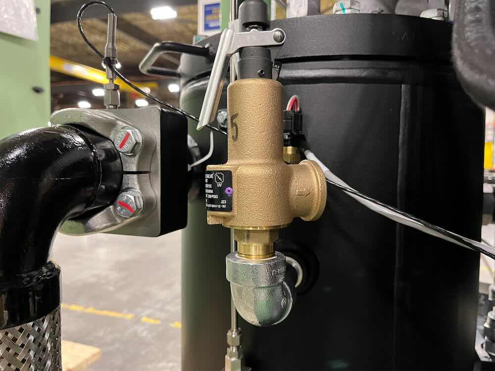

Pressure relief valves improve safety, efficiency
Quality air compressors are designed with safety in mind. For the most part, users normally do not have to worry about a safety issue arising. In fact, to prevent a potential issue, air compressors come equipped with an air pressure relief valve (PRV), sometimes called a safety relief valve, which is designed to work if other safety features fail.
The pressure relief valve protects the compressor component it is attached to from being exposed to a pressure above its rated maximum operating pressure. This rating, called the maximum working pressure (MWP), is the pressure at which the sump has been certified to continuously operate safely. When a compressor is running at or below its maximum working pressure — when it’s running “normally” — the relief valve doesn’t do anything.
However, when the air pressure inside a compressor exceeds its MWP, the pressure relief valve will activate to “blow off” the excessive pressure within the compressor. Without a relief valve, the storage tank could rupture from the excessive pressure, damaging the compressor, other property near it, and maybe causing injuries (or worse) to anyone standing nearby.
Under normal circumstances, the air pressure in a compressor is controlled by a pressure switch in an electro/mechanical control system or, in the case of an electronic controller, a pressure transducer and controller settings. When the cut-out set pressure for the pressure switch is reached, the compressor will stop compressing air until the cut-in set pressure is reached at which time it will start compressing air again.
If the pressure switch fails, the compressor would not be able to start compressing air again, or potentially worse, not be able to stop. Most compressors also have a high-pressure safety switch that should stop the compressor if the pressure exceeds the unload set point.
A pressure relief valve is a straightforward safety backup to the pressure switch and high-pressure switch, or the controller set points, should any of these components fail with the compressor running. The safety relief valve is set above the high-pressure safety switch and at or below the vessel’s maximum operating pressure. Inside the valve is a spring, and the pressure created by compressing the spring keeps the valve closed under normal operating conditions. However, as the air pressure increases in pressure vessels (like the storage tank), it may exceed the rated pressure of the relief valve, causing the relief valve to open and the excess pressure to be blown off to the atmosphere.
Image 2: Pressure relief valves are an important safety feature added to prevent pressure from building up inside a compressor. Courtesy: Hitachi Global Air Power

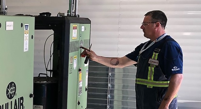

Piping leaks usually happen over time due to vibrations, hose and tubing degradation and failed compression fittings. To root out the sources of leaks, most OEMs recommend a leak audit. These audits often find inappropriate uses and loss of compressed air, so the exercise is absolutely worth the effort.
Most air auditors use an ultrasonic leak detector since most leaks are small and are not audible to the human ear, particularly in a noisy production environment.
A best practice is to document each leak when it is identified. Many ultrasonic leak detectors include cameras so the leak can be photographed allowing the user to include a description such as the location in the plant. And, along with documenting the leak information, attaching a two-part tag to the leak makes locating the leak for repair easy for the maintenance team.
Logging the intensity of the leak is also a good practice to follow. The leak intensity can be used to estimate the power cost of the leak and allows the maintenance team to determine if a leak is worth fixing. For example, the packing gland and seat in a valve are found to be leaking, but the leak cannot be repaired without replacing the valve. The cost of the valve, plus the labor associated with the repair, could cause the repair to be more expensive to fix than letting the leak continue.
Image 3: Compressed air system air leak auditing should be an on-going maintenance task. A good practice is to check the entire system annually. Courtesy: Hitachi Global Air Power
