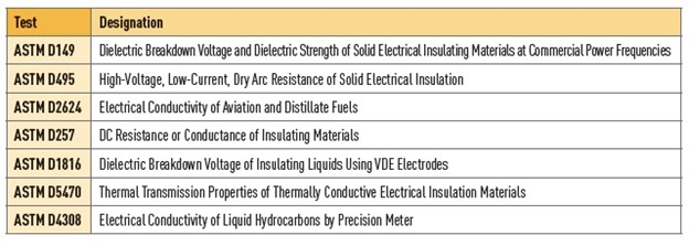

Sometimes a test for a characteristic other than those designated for grease must be used. For example, most recently, greases for electric vehicles such as dielectric, electrically conductive or thermally conductive have relied on tests that are not commonly used for lubricating grease (see Table 3). As the industry goes through the most rapid acceleration in its history, gaps in the standard tests will continue to exist, and new requirements are evolving constantly.
Table 3: Most common lubricating grease tests on electrical-related properties. Courtesy: STLE

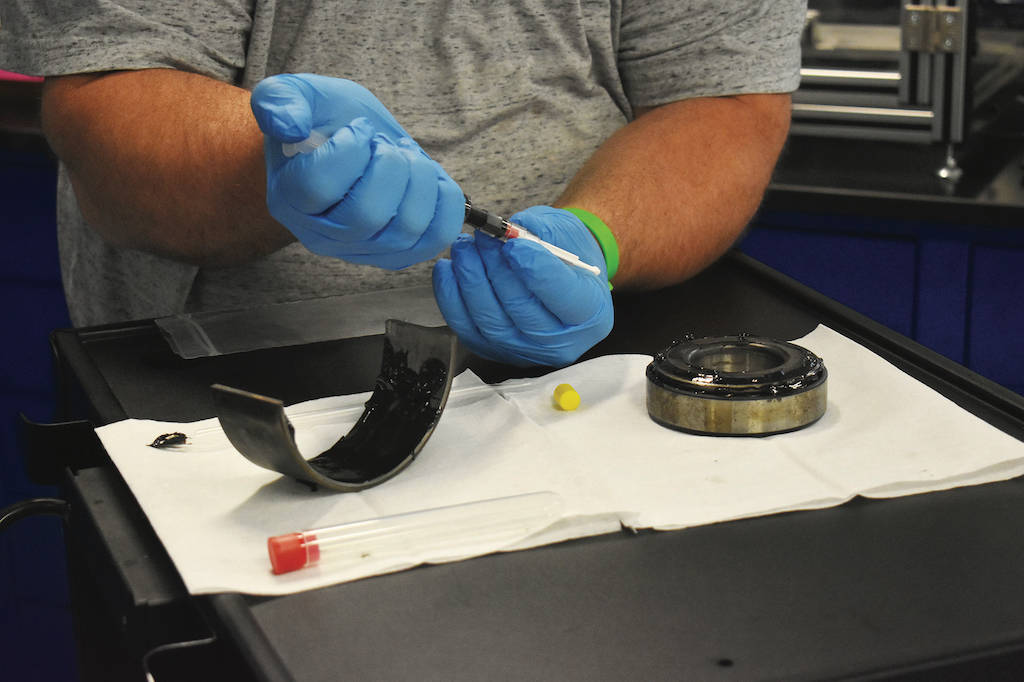

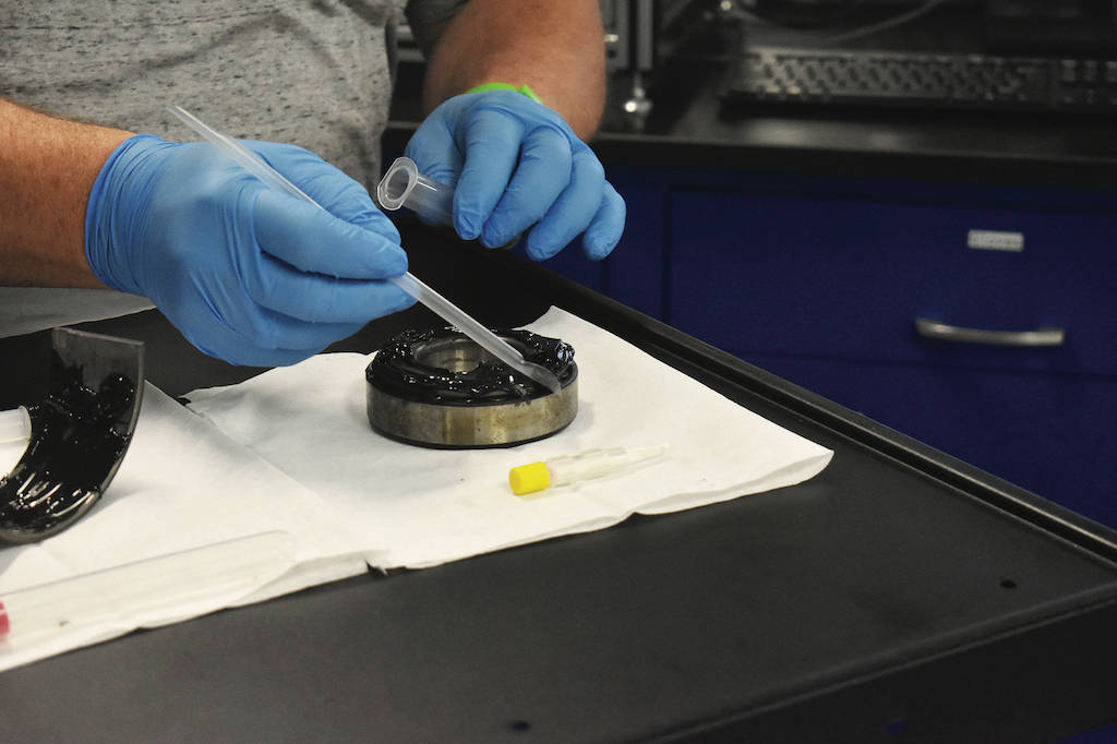

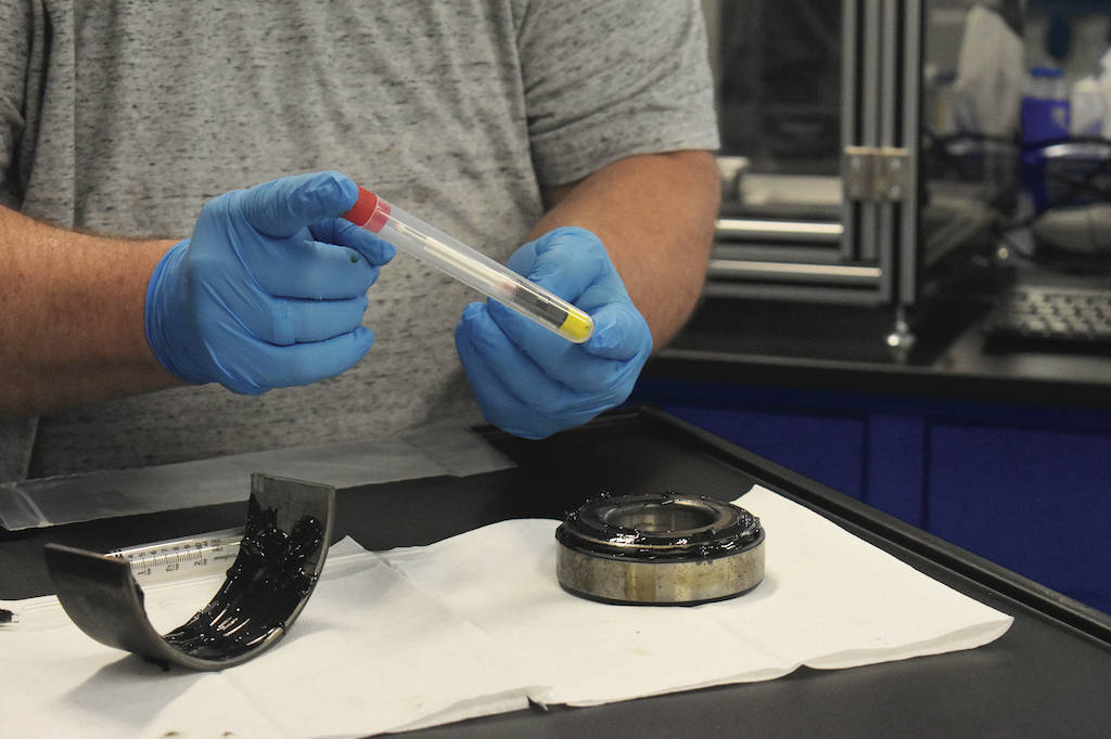

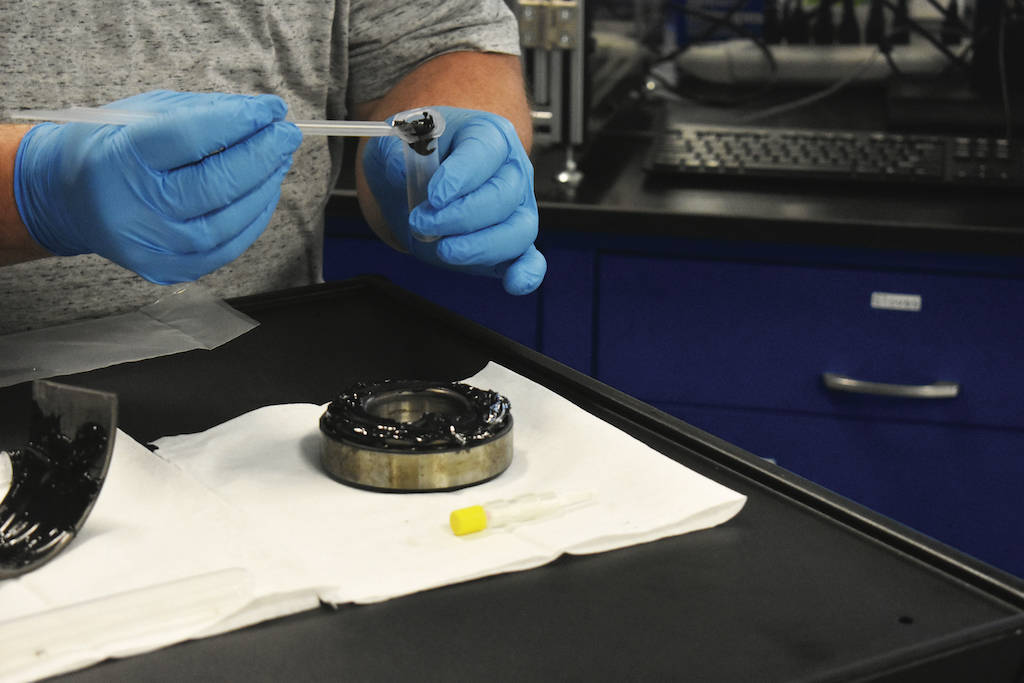

STLE member Richard Wurzbach, president of MRG Labs, explains that when it comes to in-service grease analysis (as opposed to new grease quality or properties testing), there is an ASTM standard that addresses multiple analysis tasks, ASTM D7918, ā€œStandard Test Method for Measurement of Flow Properties and Evaluation of Wear, Contaminants and Oxidative Properties of Lubricating Grease by Die Extrusion Method and Preparation.ā€
He added this method allows for six tests to be performed on a 1-gram sample. This sample must be in a specific sampler, called a ā€œgrease thief,ā€ which is described in the ASTM in-service grease sampling standard D7718 called ā€œStandard Practice for Obtaining In-Service Samples of Lubricating Grease.ā€ Figure 3 shows a grease sampler, and Figure 4a, b, c and d show steps of how the grease sample is taken.
Figure 3: Grease sampler. Courtesy: MRG Labs
Courtesy: Polaris Laboratories
Top to bottom: Figure 4a. Taking a sample, step 1; Figure 4b. Taking a sample, step 2; Figure 4c. Taking a sample, step 3; Figure 4d. Taking a sample, step 4. Courtesy: POLARIS Laboratories.

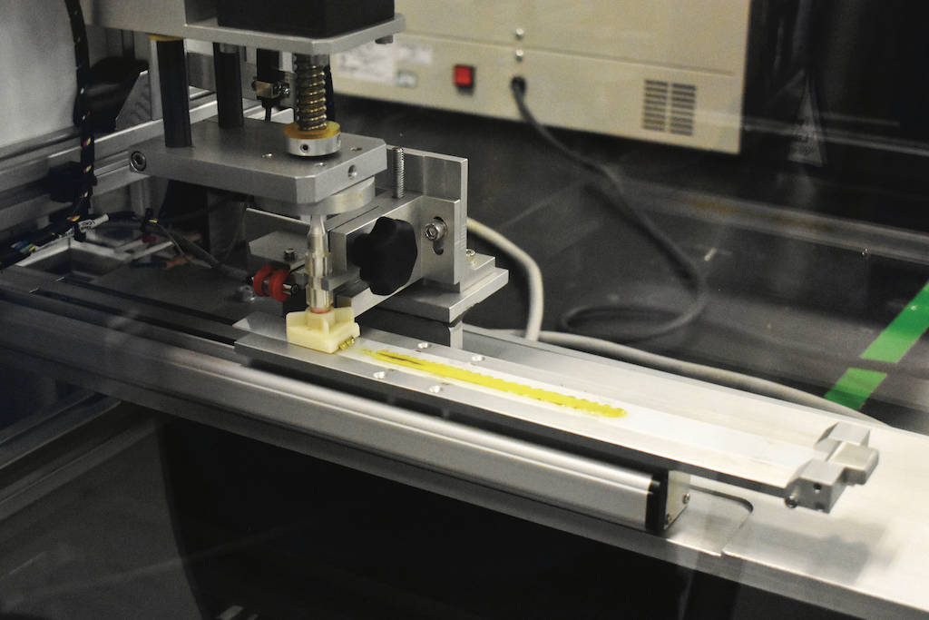

After the sample is taken, Wurzbach said, ā€œThe 1 gram of grease is first inserted into an induction coil device to measure ferrous debris level and is then extruded through a flow die to measure consistency. The exit of that die conforms the grease to a thin film ribbon that is laid on a clear plastic substrate, that is divided into sections that each hold about 0.25 grams of the sample (see Figure 5a and 5b),ā€ he adds. While being extruded, a light source and high-resolution magnifying camera are used to count and size particulate in the grease thin film for a ā€œgrease particle count,ā€ Wurzbach said. ā€œEach individual section can then be pulled away from the backing piece to be used for a further test, which includes dissolving in solvent for elemental spectroscopy tests like inductively coupled plasma (ICP) or rotating disc electrode (RDE), particle identification such as analytical ferrography, Fourier-transform infrared spectroscopy (FTIR) analysis, RULER testing for antioxidant levels, adenosine triphosphate (ATP) testing for microbial content quantification, moisture by Karl Fischer or thermal transfer and humidity sensor.
Figure 5a: Die extrusion. Courtesy: POLARIS Laboratories
Figure 5b: The exit of the die extrusion. Courtesy: POLARIS Laboratories

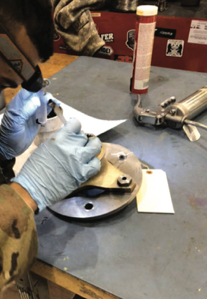

Figure 6: In a project to test in-service greases for Chinook H-47 helicopters, a soldier took a grease sample, and the sample size was frequently less than 1 gram. Courtesy: MRG Labs

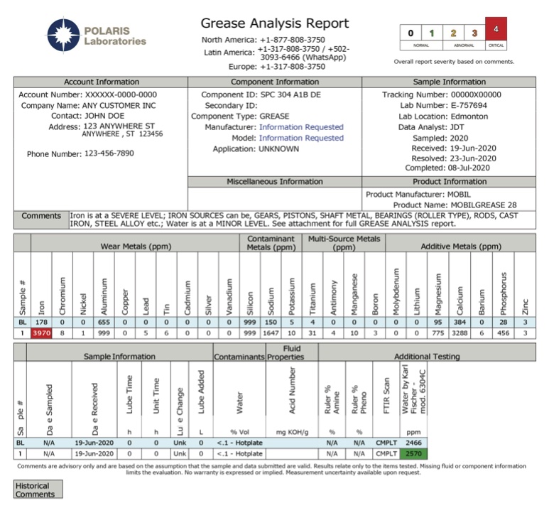

An asset owner can easily document its reliability with the long-standing industry methods. Williams explains that in oil analysis, many have adopted the ā€œstop lightā€ (red–yellow–green) philosophy to evaluate the condition of a sample in three key areas: wear, contamination and physical properties. She adds that with grease analysis, the same evaluation technique can be used—but with an additional component such as thickener component of the grease. The thickener component also can be referred to as the NLGI grade or consistency. ā€œIt’s important to understand the consistency of the grease and how it has changed over the service life of the grease,ā€ Williams adds. Figure 7 shows a sample of a grease analysis report.
Figure 7: In-service grease analysis report example. Courtesy: POLARIS Laboratories
In-service grease testing builds a proper trail of information to document performance. The testing is repeatable, and it is reliable. Wurzbach noted the keys to grease testing being repeatable and reliable are in both the effectiveness and consistent method of sampling, and the use of defined and standardized methods for analysis.
ā€œPresently, ASTM is conducting an interlaboratory study for ASTM D7918 to determine statistical repeatability and reproducibility of this method at 14 participating laboratories. ASTM D7718 provides the necessary guidance for tools and methods to achieve the consistent sampling required,ā€ Wurzbach said.
The in-service testing results offer significant insight into the performance of the grease. Wurzbach states that in-service tests can be used to evaluate the effectiveness of a given lubricant in the specific application. ā€œGrease analysis can be used to monitor machine health by determining wear quantities, materials and modes,ā€ he adds. ā€œContaminant levels can be quantified to determine the effectiveness of sealing mechanisms, or the rate of regreasing used to purge those contaminants present in the immediate environment. The consistency of the grease can be measured to ensure that the grease continues to possess the qualities needed from the grease: to stay in place where applied, and to flow as needed to provide lubrication to moving parts,ā€ Wurzbach said. He then adds that the oxidation condition of the grease, as measured by FTIR and antioxidant measurement (RULER), shows the life of the grease and helps to optimize replenishment frequency and quantity. ā€œIf these four aspects of grease performance, wear, consistency, contamination and oxidation, are monitored and lubrication practices adjusted to achieve optimization, that life of the grease and the lubricated asset can be maximized,ā€ Wurzbach explains.
Additionally, in-service grease results can be trended to prevent failures. Williams says that in condition-based maintenance, results should always be trended in order to make the best decision in the future. ā€œRarely an analyst would take a single point in time and make a decision about a component,ā€ she adds. ā€œRather, an analyst would establish trends and statistics that let evaluate deviations from the trend as compared to a brand-new sample. Figure 8 shows a grease analysis report with trends and comments.
Figure 8: In-service grease analysis report example. Courtesy: POLARIS Laboratories.

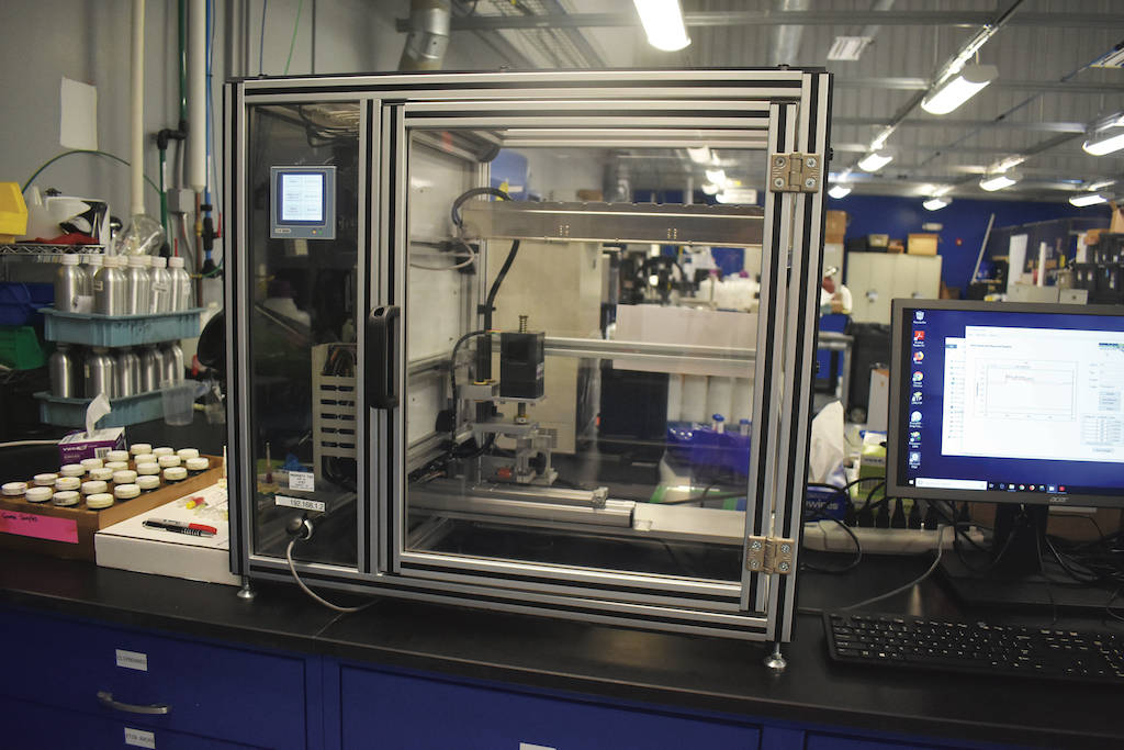

When necessary, an asset owner can implement an ā€œonsiteā€ analysis of grease to ensure performance remains high. Wurzbach states that there are several onsite tools available for grease testing. ā€œThere are kits that allow testing of greases for contaminants, consistency and a sort of thermal separation point,ā€ he said. ā€œIt involves using a microscope to look at the grease through a clear plate for contaminants and wear particles, a weight that is used to squeeze a small grease amount and give insight to the NLGI grade based on its movement and a paper and hotplate method that allows a measure of the oil bleed into the paper.
ā€œFor perhaps less subjective testing, a mini lab also is offered that works with the ā€œGrease Thiefā€ sampler outlined in D7718. It utilizes an induction coil that is calibrated to the sample geometry to produce a ppm level for ferrous debris. It is complemented by a colorimeter method that prepares precise thin films of the grease for a transmission cell visible light spectrometer. This produces spectral color data and a CIELAB Delta E value, similar to the Membrane Patch Colorimetry measurement, that can be compared to new greases to generate trendable values and action criteria.ā€ These two instruments can be battery operated and can communicate with Bluetooth to mobile devices, and are referred to as the Grease Thief Mini-Lab.
