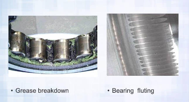

Because of the pulse-width modulated signal the VFD is sending to the motor, the motor terminals may actually see a peak voltage of three to four times the rated voltage of the machine. Higher quality VFDs find ways to mitigate this, but not all of them. The issue becomes especially bad when you have long leads between the VFD and the motor, which is very common in industrial facilities.
You may have a control room on one end of the plant where VFDs are housed that are feeding motors all across the facility. This is not good news for the motor windings.
