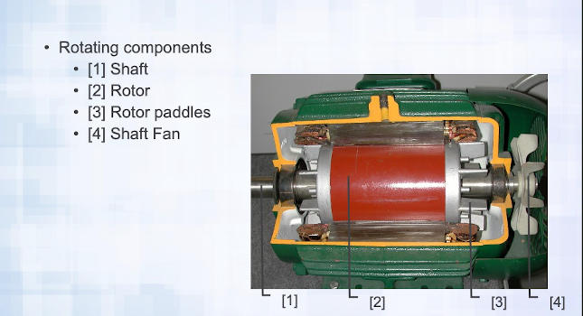

Single-phase motors will typically be found in residential or smaller agricultural applications and three-phase motors will be found in industrial and even larger commercial applications. Induction motors have been around since the 1800s. But that doesn’t mean that they’re really old news. In general, they have simple, straightforward operation and are somewhat easy to produce at high volumes. They’re also very rugged and typically pretty reliable. That’s why they’ve lasted since the 1800s.
Courtesy: CFE Media, Advanced Energy Corp.[/caption]
Next slide we have housing components. In bells on both sides of the machine, the bearing housings and stator housing, which are both painted orange here, the cooling fans on the outside of the motor, the junction box, where the motor terminals are found. It’s hard to see. It’s kind of in the back of the motor on this picture. And then finally labeled number nine will be the fan shroud and that’s used to safely guard the fan during the motor operation.
