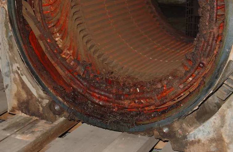

Motor circuit evaluation (MCE) testing provides a heads-up when a motor is nearing the end of its useful life. If the megohm (commonly called “megger”) part of the test shows resistance to ground is less than 100 ohms, the motor is nearing the end. Surge testing tends to back up results of the megger test if surge patterns are uneven. Hi-pot testing is a go/no-go test in that it is destructive to windings; a motor that fails a hi-pot test is no longer serviceable.

In simplest terms, EE motors are made more efficient by tightening manufacturing tolerances and packing more conductor into the motor to reduce internal losses. Likewise, repair technology has become more precise, too, and the degradation of efficiency that was common in a motor rewind has been cut drastically. Now, repair shops can rewind a motor to its original nameplate efficiency and, in certain circumstances, improve efficiency. This applies to both standard and EE motors.
Obviously, the cost of a rewind can vary with the degree of internal damage, but a typical price for a 100-hp induction motor that we will use as an example is between $2,500 and $2,700—or $2,600 average per IPS Washington Service Center price guidelines.
