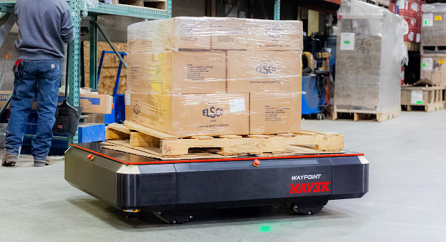

Jason Walker, the CEO and co-founder of Waypoint Robotics, believes the need for AMRs is growing because employers can’t find enough workers to hire. Walker said, “Our value proposition is: ‘Let’s take the people you’ve already got who you know and trust and love, and let’s give them better tools.’”
Waypoint’s AMRs are ready to work soon after they arrive on a loading dock. They don’t need weeks of attention from engineers to get up to speed. They can drive through a factory once and make a map that will guide its future movements. Waypoint’s Vector, which has payloads of 300 pounds and 600 pounds, and MAV3K, which carries up to 3,000 pounds, can move materials efficiently. MAV3K can “move pallets and large material loads, and it’s great for mobile manipulation with really big arms,” Walker said, but it’s not a forklift, and so it doesn’t work alone.
The future for AMRs involves heterogenous fleets of AMRs, Walker said. “We’ve built our systems so that they are easy to integrate and are interoperable with all kinds of third-party external systems.” He envisions AMRs from multiple manufacturers working together to complete jobs.
Through a partnership with Wibotics, Waypoint has adopted a wireless charging method called EnZone which uses radio frequency at multiple sites within a workplace. “As long as you get the receiving antenna within about an inch of the transmitting antenna, it will charge at full power, and it will do it all day long.”
