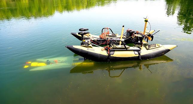

Robots can be amazing tools for search-and-rescue missions and environmental studies, but eventually they must return to a base to recharge their batteries and upload their data. That can be a challenge if your robot is an autonomous underwater vehicle (AUV) exploring deep ocean waters. A Purdue University team has created a mobile docking system for AUVs, enabling them to perform longer tasks without the need for human intervention. This could provide benefits for a number of underwater operations including oil and gas exploration.

“And what if we had multiple docks, which were also mobile and autonomous?” she said. “The robots and the docks could coordinate with each other, so that they could recharge and upload their data, and then go back out to continue exploring, without the need for human intervention. We’ve developed the algorithms to maximize these trajectories, so we get the optimum use of these robots.”
The researchers validated the method by testing the system on a short mission in Lake Superior.
“What’s key is that the docking station is portable,” Mahmoudian said. “It can be deployed in a stationary location, but it can also be deployed on autonomous surface vehicles or even on other autonomous underwater vehicles. And it’s designed to be platform-agnostic, so it can be utilized with any AUV. The hardware and software work hand-in-hand.”
