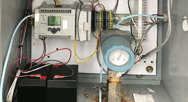

Specialized tools ease upgrades
Many major PLC manufacturers offer hardware and software migration tools for facilitating the upgrade from legacy to modern PLC systems. While these may not represent a perfect plug-and-play approach, they go a long way toward minimizing risk, effort and cutover time.
Hardware tools include wiring harnesses, which are installed on top of existing legacy wiring terminals, to provide a mounting interface for newer modern terminals. These modern terminals can be wired to the legacy terminals to tie existing field wiring into the new hardware while keeping the existing field terminations intact (see Figure 3).
A careful design will ensure retrofit work can be performed in the space available. Sometimes more extensive remove-and-replace work is needed, and in these cases the ability to assemble preconfigured hardware fabricated in a shop will speed site installations (see Figure 4).
Software conversion tools take legacy PLC code and upgrade it to a format compatible with modern PLC programming software. These software tools convert most of the program logic, but still require some attention by programming personnel to handle unsupported functions or data types that vary from one generation or model of PLC to the next, such as PLC-sourced peer-to-peer (P2P) messaging.
When upgrading an automation system, it is important for end users to communicate closely with their system integrators, distributors, contractors and equipment manufacturers. Holding workshops among these groups is a prime opportunity for everyone to understand the existing equipment (including equipment lifecycles) and discuss the best methods for upgrading.
Workshops also provide a forum for discussing and tracking project decisions as the control strategies are more fully understood. Having a solid understanding of the existing system facilitates the process of upgrading and minimizes process downtime.

Project 1: Rockwell Automation
The situation: A municipal wastewater treatment plant was performing hardware upgrades to their automation system. Their existing system consisted of a Rockwell Automation FactoryTalk View SE supervisory control and data acquisition (SCADA) application that communicated with multiple Allen-Bradley PLC-5 controllers via a ControlLogix gateway.
While the plant was comfortable with the existing SCADA application and PLC programming, they wanted to upgrade their PLC hardware from PLC-5 to ControlLogix. They also wanted to consolidate the programs of the PLC-5s into redundant ControlLogix PLC pairs, and to handle all remote input/output (I/O) (RIO) using Ethernet. Additionally, there were plans to convert the plant network from a proprietary DH+ network to a fiber optic EtherNet/IP network.
After reviewing the end user’s well-documented copies of the existing PLC programs and comparing the current state of the system to the end user’s desired result, Tesco Controls worked with them and developed a plan to upgrade the PLC hardware from PLC-5 to ControlLogix, while maintaining the SCADA application. This was accomplished by converting the PLC-5 program code to be compatible with redundant ControlLogix PLCs and Ethernet RIO, while maintaining the same look and feel of the existing program and updating the PLCs’ network configurations to accommodate the new fiber-optic EtherNet/IP network.
The solution: Tesco Controls leveraged Rockwell Automation’s conversion products and tools to efficiently migrate the existing hardware and software.
To integrate and install new ControlLogix hardware, Tesco Controls used Rockwell’s hardware retrofit kit. This kit allowed the existing PLC-5 terminations to remain in place, and those terminations connect to new ControlLogix I/O modules through a conversion harness (see Figure 5).
Using Rockwell’s software conversion tool, Tesco Controls was able to mimic the PLC-5 coding style in the ControlLogix programming environment. However, to accommodate the newer features of the modern programming software, some revisions were required.
Because I/O cards are handled differently between the two platforms, the scaling for each analog point needed to be individually checked and configured. This is because of the differences in how PLC-5s access analog data compared to ControlLogix systems. PLC-5s use specific block transfer reads and block transfer writes, while ControlLogix PLCs read and write data natively through the program I/O tree. Due to this difference, the program often required additional logic to fully replicate the functions of the original program.
With the upgrade to ControlLogix PLCs, the program logic associated with messaging and peer-to-peer communication needed to be updated to accommodate the modern EtherNet/IP protocol, as PLC-5s natively use the legacy DH+ protocol. To meet the requirements of the EtherNet/IP protocol, each instance of messaging logic needed to be configured individually so the ControlLogix PLCs could communicate with remaining PLC-5s using an EtherNet/IP to DH+ gateway.
Proportional-integral-derivative (PID) analog loop control also has differences between the two platforms. One example is how the PID block scales its inputs and outputs. To migrate this aspect of the PLC program, Tesco Controls kept the existing registers and SCADA tags intact to maintain their compatibility with the original logic and SCADA system. However, the PID values were modified as needed to accommodate the ControlLogix PID instruction.
For the SCADA application, Tesco Controls developed its own software tool to automate the tag conversion to expedite the conversion of the existing PLC-5 tags into ControlLogix tags. This custom tool helped eliminate potential transcription errors that could arise from manually converting the tags. This tool was used to convert the tags in a bulk manner for one process area at a time, and each set was uploaded to the existing SCADA system for testing before integration into the live system.
Tesco Controls successfully cut over one PLC per day, with each hardware cutover taking approximately 20 minutes, and with the software cutover and overall testing and verification completed during the remainder of the day.
Tesco Controls performed a relatively seamless hot cutover of the PLCs using good documentation practices, appropriate contingency plans and a thorough understanding of the plant’s operational characteristics and the end user’s goals.
