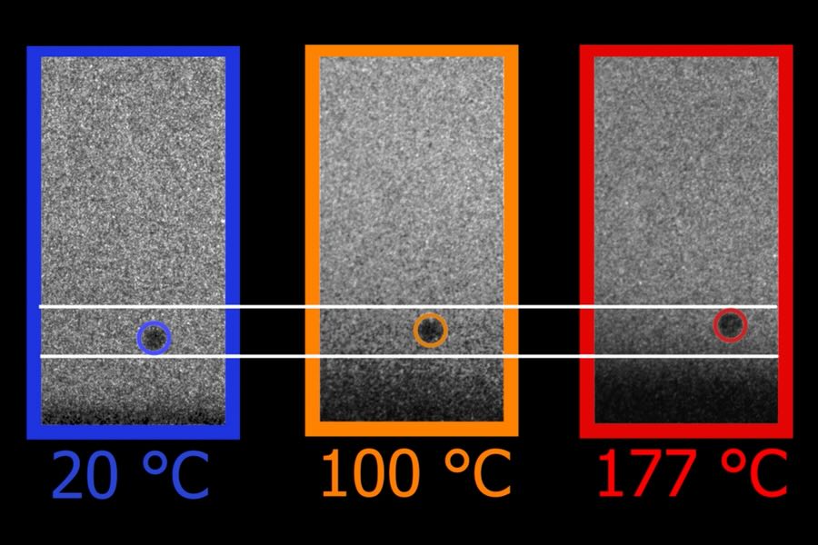

MIT scientists discovered that when metals are deformed at an extreme rate by an object moving at high velocities, hotter temperatures make the metal stronger, not weaker. Here, 3 particles are hitting a metallic surface at about the same velocity. As the initial temperature of the metal is increased, the rebound is faster, and the particle bounces higher because the metal becomes harder not softer, too.
MIT scientists discovered that when metals are deformed at an extreme rate by an object moving at high velocities, hotter temperatures make the metal stronger, not weaker. Here, 3 particles are hitting a metallic surface at about the same velocity. As the initial temperature of the metal is increased, the rebound is faster, and the particle bounces higher because the metal becomes harder not softer, too. Courtesy: Massachusetts Institute of Technology
