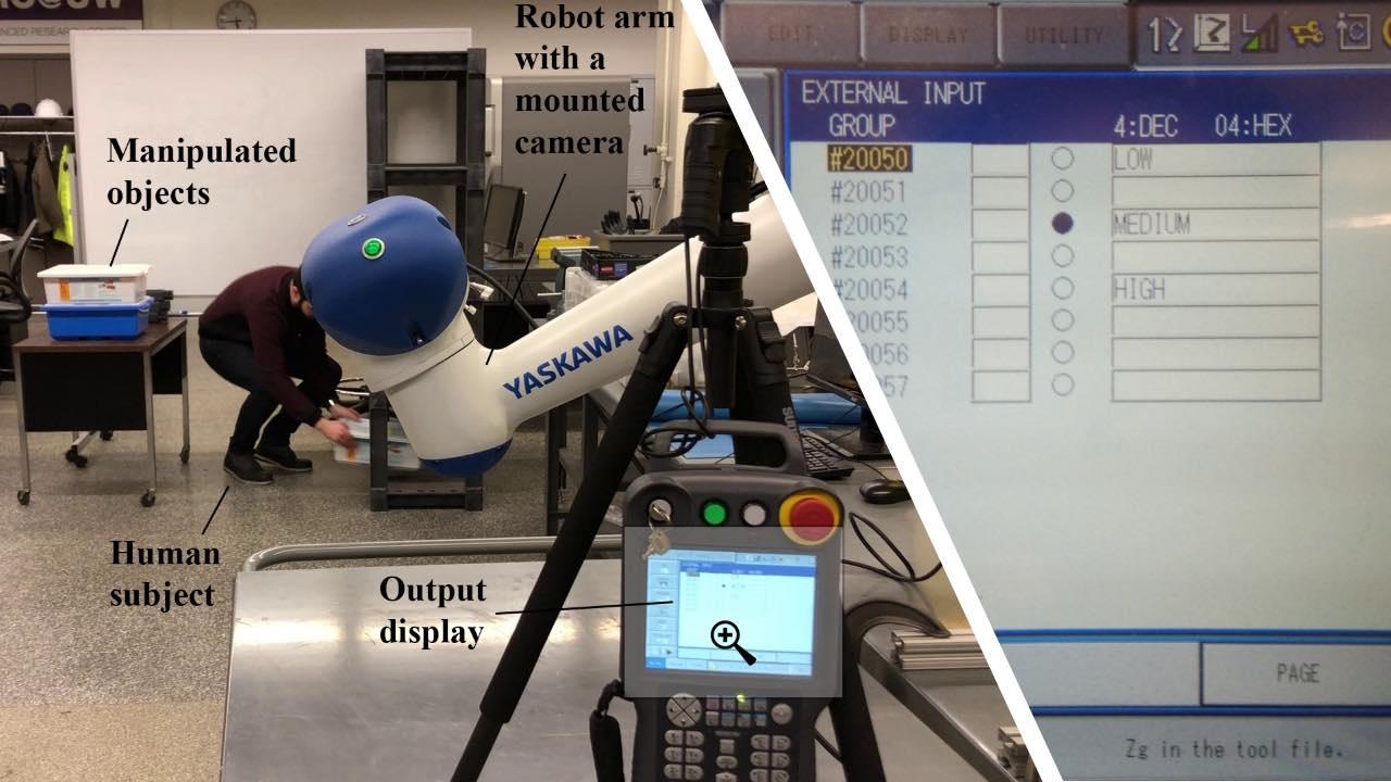

Eventually, the researchers want robots in warehouses or factories to be able to use the algorithm to help keep workers healthy. To see how well the algorithm could work in a hypothetical warehouse, the researchers had a robot monitor two participants performing the same activities. Within three seconds of the end of each activity, the robot showed a score on its display.
