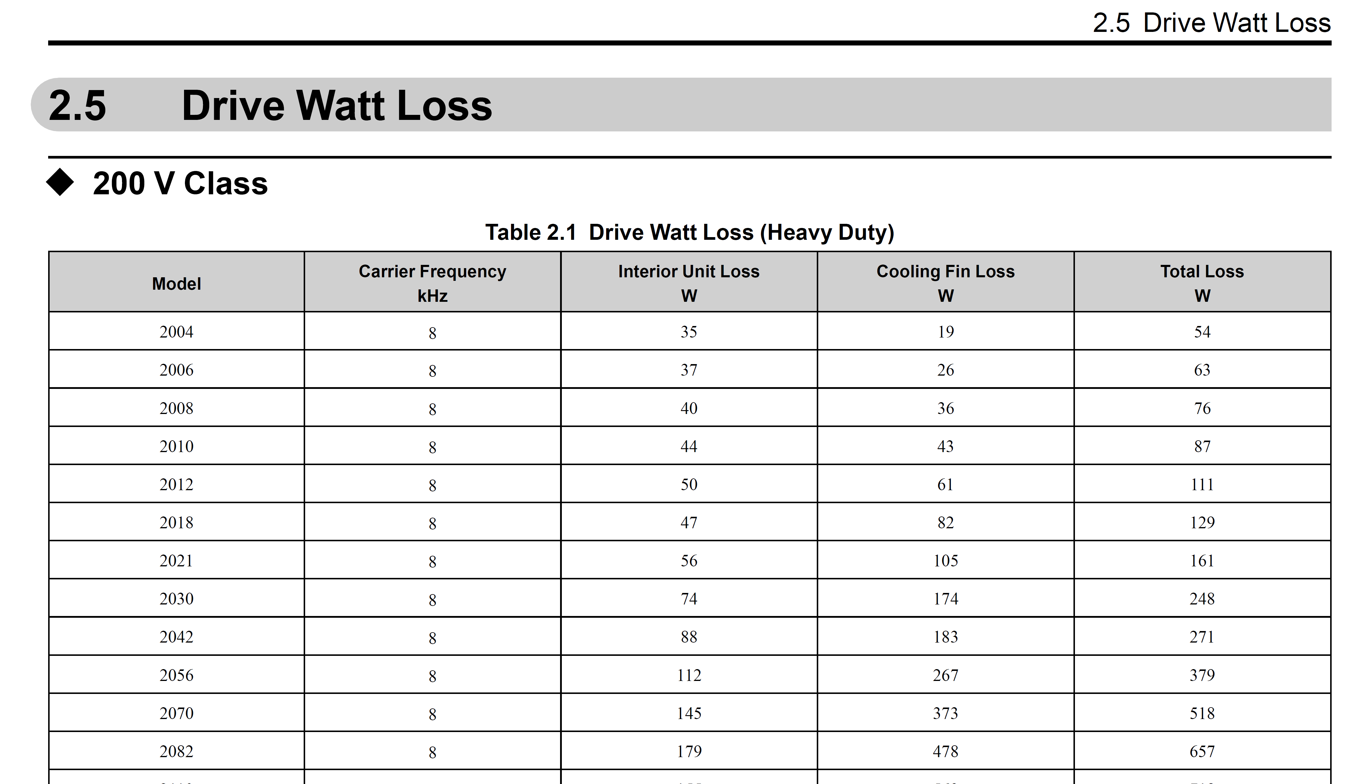

Heat issues come from two distinct sources: ambient temperature and heat caused by passing large enough amounts of current through metal conductors. See Figure 1 for a watts loss table. For more technical details, visit IEEE.
Calculating VFD heat loss
Because we are discussing a modern VFD, users can get a pretty good idea of watts loss at full load from the technical manual provided by the manufacturer.

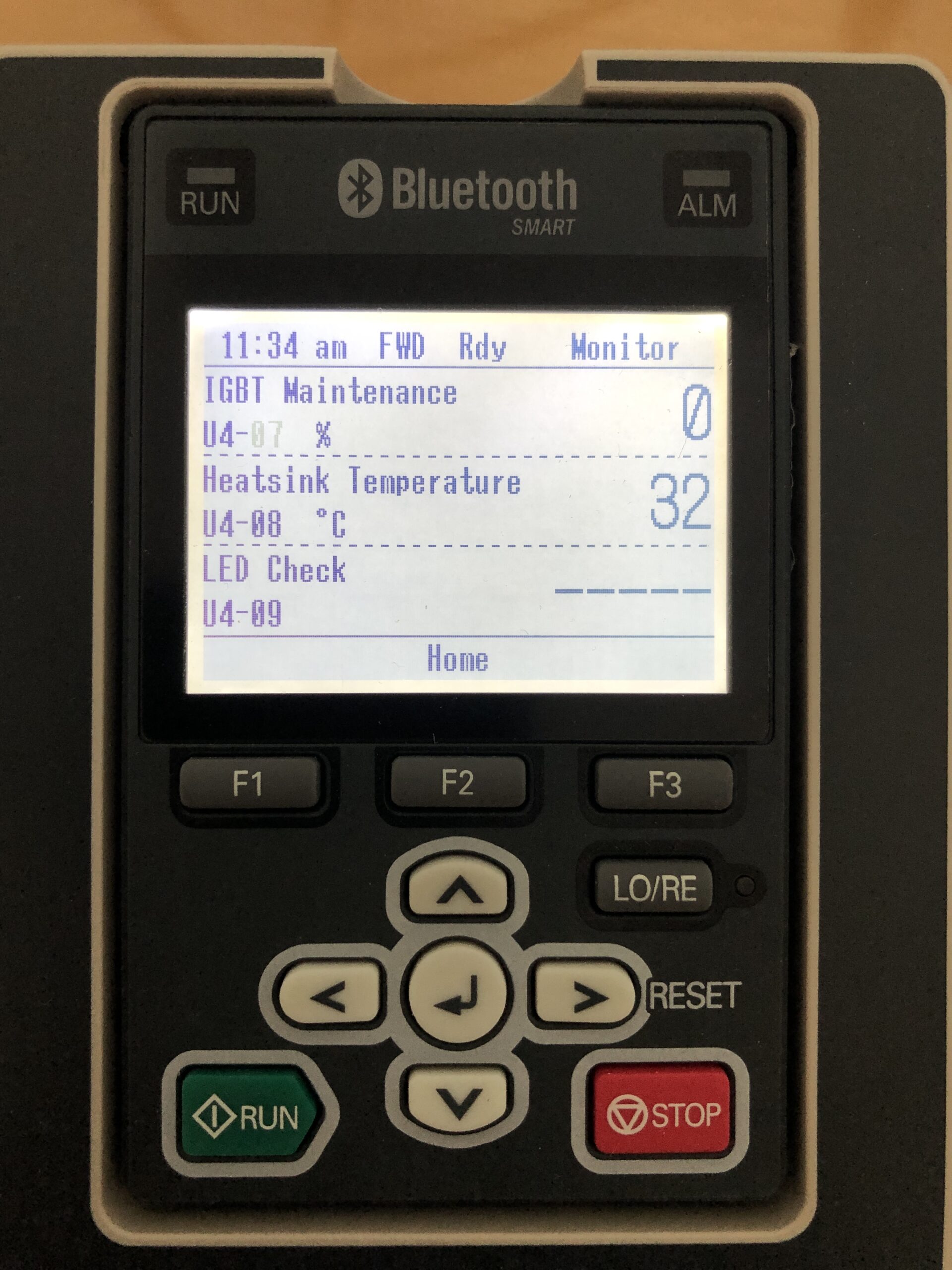

The unit to measure heat loss is watts. On top of that, devices used in the manufacturing of modern VFDs feature temperature measuring devices built in. Most of the current that will go to creating heat will at some point pass through the VFD’s insulated gate bipolar transistors (IGBT).
IGBTs are the very fast, very efficient output switches that create the pulse width modulation waveform that is applied to the motor to create torque and power. Modern IGBT modules also have built-in thermistors measuring the heat that the module is experiencing. No formulas are required. At most, you will just have to check a keypad monitor for the exact drive temperature or maybe just read it over a network connection in real time.
Figure 2: Heatsink temperature monitor. Courtesy: Yaskawa America Inc.
Figure 3: Peak current monitor. Courtesy: Yaskawa America Inc.
The only issue with real time temperature monitoring is that it can’t differentiate between heat rise due to usage and the heat due to ambient temperature. So part of any installation and subsequent maintenance is to always control the ambient temperature around the VFD. Even when not being used, the drive can never cool down any lower than ambient. The higher the ambient, the less of the heat rise that is allowed before your VFD has to shut down on a temperature fault. It is safe to assume that if you trip on a high-temperature fault too often, it probably won’t be good for your drive components. Moral to the story: try not to cook your VFD.

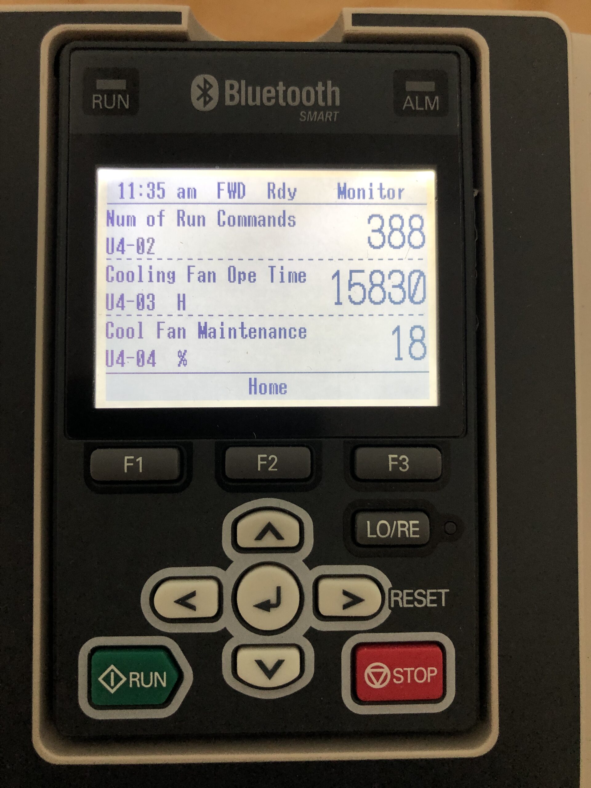

Learn to check the VFD fans
For the heatsink to do its job of cooling the drive devices adequately, it may require ambient air to be constantly blown across the fins for them to cool down more quickly. This, in turn, allows it to absorb more heat from the drive. This makes heatsink fans critical for tripless operation and long VFD life.
Some smaller drives don’t require heatsink fans while some larger drive might require three or four large fans. The proper amount of cubic feet per minute necessary was calculated by the drive designer based on heat loss of the current carrying devices running at the drive’s temporary overload ratings. Therefore, at normal operation (not in overload), there should be a slight excess of airflow. Still, all fans will need to be turning at their rated speed and in the proper direction.
Fans can be checked to be sure that they spin freely while unpowered and simple observation during a drive run state should show all fans spinning. Modern fans are probably hardier than some even a generation ago and most now include hall-effect sensors that will assure that the fan is spinning when it is supposed to be.
If the fans do have sensors, the VFD will either trip when a fan fails or will warn the user that at least one fan is not operating properly. Even if the drive doesn’t trip for a failed fan, if the temperature of the VFD cannot be maintained within the VFD specification, the thermistor in the IGBTs will report the temperature to the control board and the control board will shut down the drive to save the components in the drive.

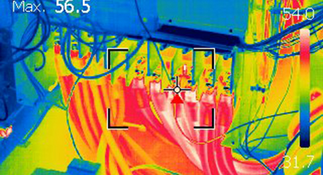

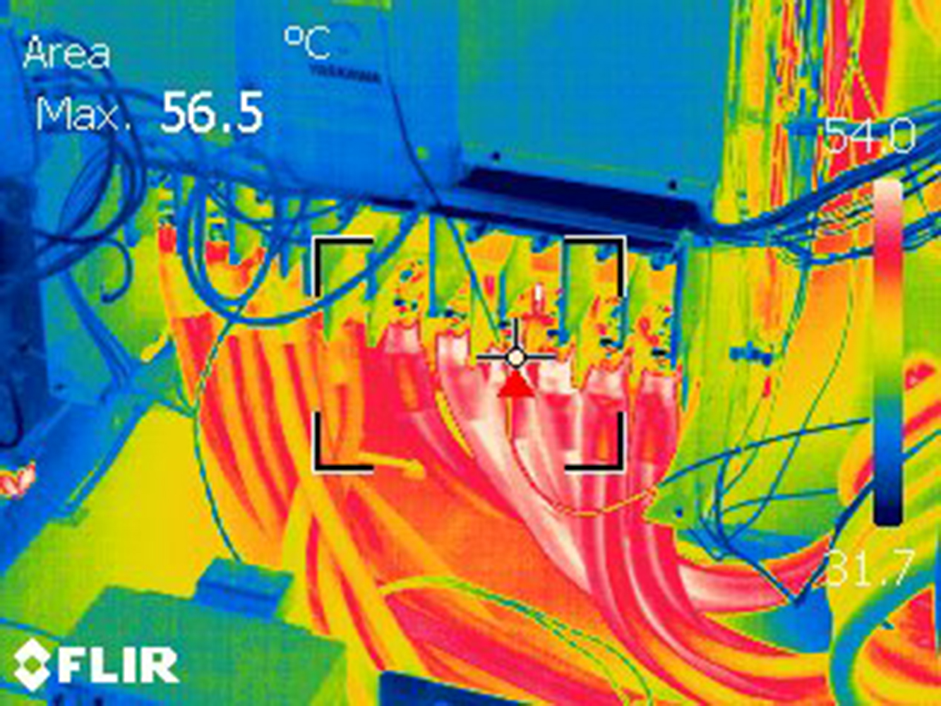

Figure 5: Infrared camera image. Courtesy: Yaskawa America Inc.

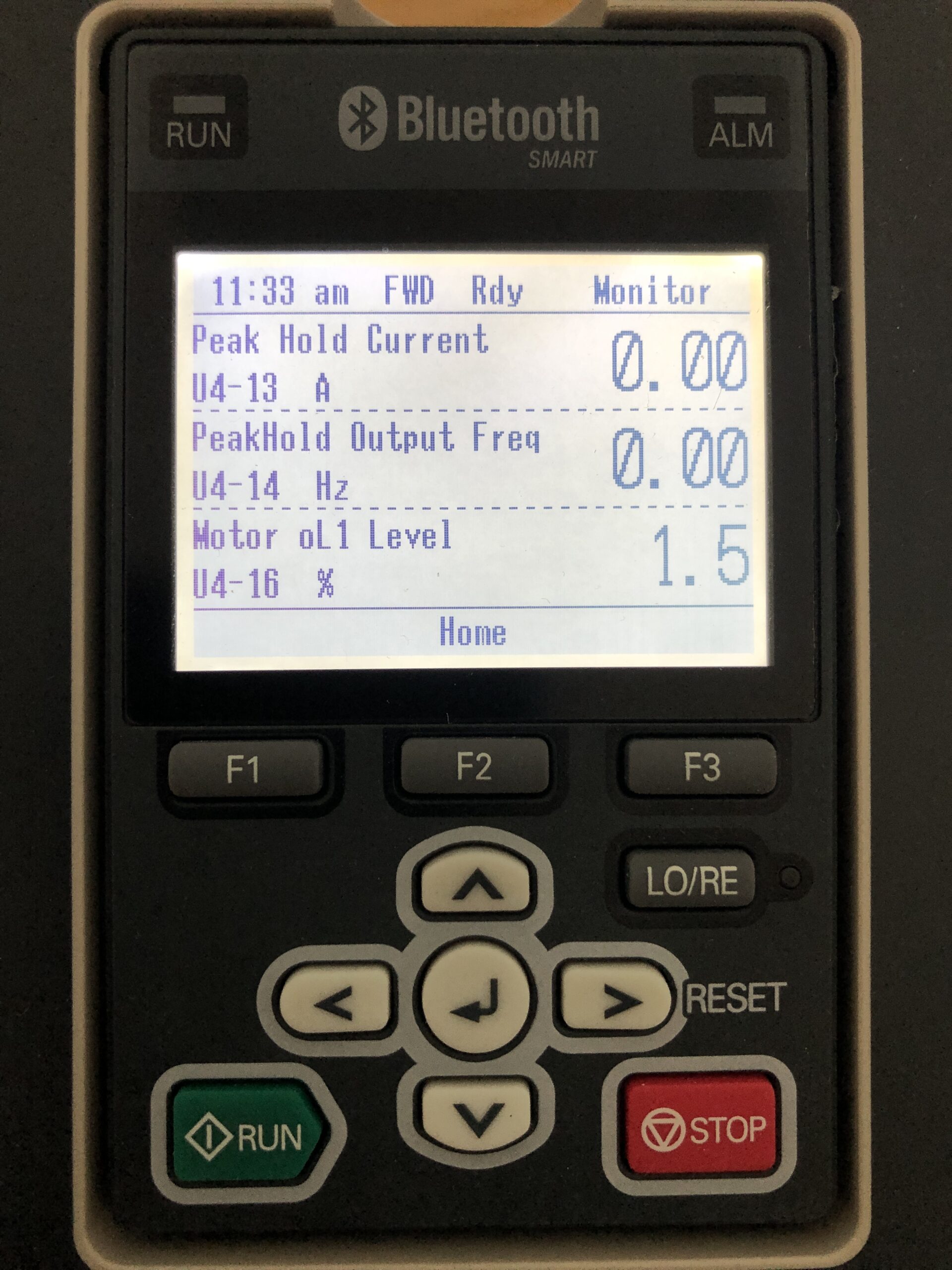

Look at the VFD’s load (current)
It might seem like doing a load check is not part of a maintenance routine. VFDs have continuous and overload current ratings. The continuous rating is like it implies — all day, every day. The overload rating is just for short-term and intermittent usage.
The more time spent pumping overload levels of current through the VFD, the more likely it is that the drive won’t live as long as it was intended. Occasional overload, especially for accelerating large loads, is OK and what it is intended for.
But overuse of the overload capabilities can be detrimental. Some drives offer monitors that will track the peak current during each run state and inform the user at what frequency the drive was operating at when the peak was hit. If a VFD offers this kind of information, it may be a good part of vetting the health of the drive to run the application and let the drive tell you the peak current pushed through it during a typical operation.

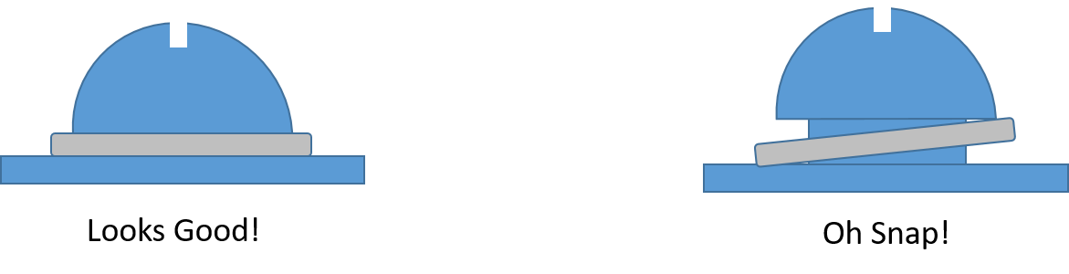

Check the connections
Why check all of the power and control connections on a VFD? Weren’t they properly torqued down to exacting specifications during install? This is yet another reason to have personnel that are factory-vetted performing the VFD installation.
But due to vibration and usage, the control and power connections may become loose. What kind of issues can a loose control connection create? Most control connections are of low power types, like 24 volts direct current Vdc or 4 to 20 milliamps mA, for example. The loose connection can cause intermittent or inappropriate operation of the application.
Loose power connections are a whole different story. Due to the larger currents passed through power connections, loose connections can cause heat and even a combustion issue. When a power connection is loose, there is less connection area passing the current between conductor and the connection surface. This increases the heat produced by the current passing through, a type of bottle neck. Think of it as trying to pass too much current through an undersized conductor (thin wire).

The result is a level of heat that will cause thermal damage and possibly fire. A good PM program uses thermal scans of power connections to look for inappropriate levels of heat around power connections.
Again with the heat, albeit for a different reason than component wear and tear.
