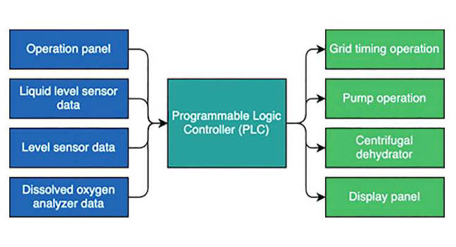

A PLC can read data from sensors and initiate responses and adjustments based on current and targeted levels. Operators can set tolerances and desired levels, but the system can promptly make changes autonomously. This improves performance and efficiency by enabling quicker response times and reducing human error. An example applying PLCs to automatically coordinate various sewage treatment systems is shown in Figure 1.
