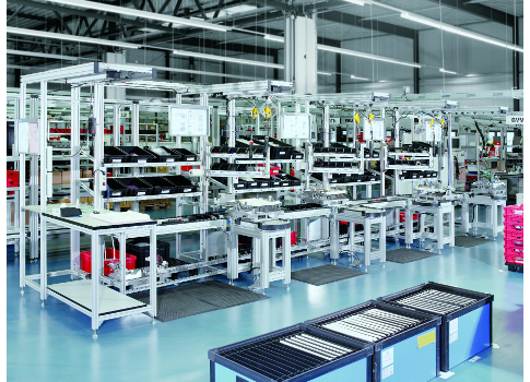

A helpful approach to choosing the right production systems is to think in terms of production volume and product mix, and to chart these factors in a matrix. One matrix that Bosch Rexroth has created plots the four broad types of most commonly used production systems: manual production systems, modular production systems with some automation, standalone automated production cells, and fully automated production lines.
This useful decision matrix can help you choose the right Lean production technologies, by assessing your flow in terms of production volume and product mix, and charting these factors against different types of production solutions.
Depending on where your situation falls on the Lean production matrix, the level of automation you need may range from no automation at all (manual production) to fully automated production.
In the most unpredictable assembly environment—low volumes, high product mix—manual assembly is usually the reasonable choice because you’d never recoup your investment in automated equipment. It’s a dynamic set of considerations, with no one right answer.
In some assembly operations, manual production is augmented by automated intelligence: A new generation of cordless nut runners for assembly operations has an integrated controller that temporarily stores the results of every nut tightened, and then transmits that data via Wi-Fi to a receiving station and the production platform’s quality-tracking system.
This ensures, through automated data capture, total tracking of the quality of manual production through integrated intelligence, while at the same time eliminating the need for redundant, manual, post-operation checking.
