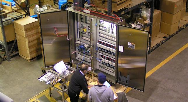

Expertise in technology, production and proves knowledge are essential to successful systems integration projects. Courtesy: Vac-U-Max

Sometimes conveyor design is uncomplicated, and the control system is what sets the installation apart. Note that some conveyor manufacturers are also U.L. listed builders and suppliers of electrical control panels and PLCs.
