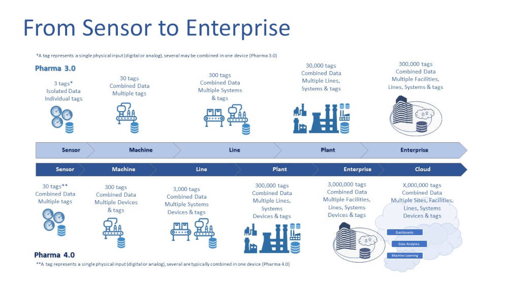

If one was to consider an Industry 3.0 manufacturing process versus a similar Pharma 4.0 manufacturing process in life sciences and the data that is generated from PLCs, SCADA or similar systems would vary drastically between them. The below image depicts the relative number of data tags (I/O inputs) attributed to a Pharma 3.0 manufacturing facility versus a Pharma 4.0 manufacturing facility.
pharma 4.0
Courtesy: IPS
The Pharma 3.0 and 4.0 facilities and processes are similar in many perspectives, but the complexity rises exponentially with an increase in available sensor parameters (data) and integration in Pharma 4.0 architectures. Pharma 4.0 also adds the additional layer of on-premises and/or internet/cloud connectivity and data analytics.
The potential increase in the volume and resolution of data generated in the Pharma 4.0 manufacturing process can be ten times that of the Pharma 3.0 process. This volume and complexity of data is one of the reasons that we see slow adoption by many manufacturers, or full to partial adoption by only larger life sciences organizations with abundant resources.
