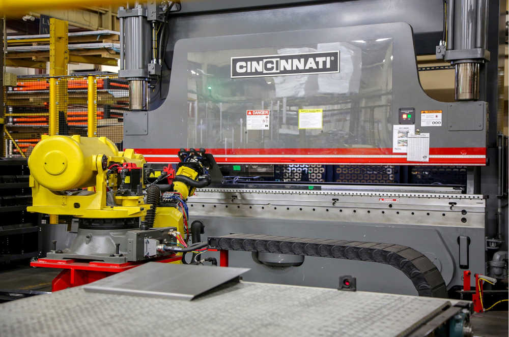

Integrated stepper motors were designed into a series of sheet metal–bending press brakes from Cincinnati Inc. (CI), a machine tool manufacturer.
The press brakes have one or more motorized edges called backgauges, which serve as dimension and orientation references. Much like a professional-grade table saw’s rip fence, backgauges on industrial press brakes help operators accurately position material against tooling.
Material shaped by a press brake is manually or automatically pushed into and held against the backgauges. Then a press mold lowers into the material to crimp, curve or bend it. To reduce design costs and maintain quick and precise positioning of backgauges before each metal-forming cycle, CI chose integrated stepper motors.

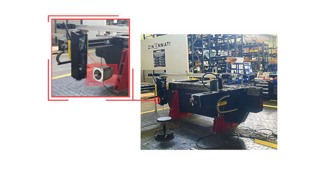

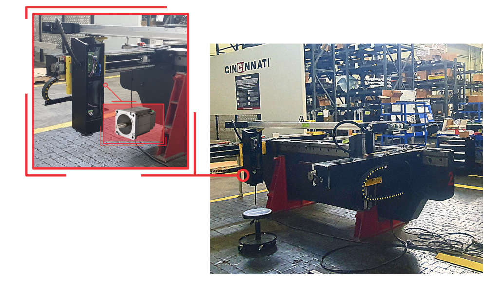

Press brake backgauges use one to six electric motors (often servomotors) to position workpieces in multiple directions. Those with six motorized reference surfaces provide two reference points in each direction of 3D space for the reliable forming of complicated parts. Most new press brakes come standard with multi-axis motorized backgauges. CI used two “motors for the backgauge vertical axis — called the R-axis on press brakes. Then we use other motors for the X- and Z-axis on the horizontal plane,” said CI electrical engineering manager Bill Molleran.
The motors are integrated stepper models with a NEMA 34 frame size and torque capabilities of 3.5 Nm.
CI switched to these steppers on the vertical axis as a cost-efficiency initiative. Previously, the vertical axis was moved by permanent magnet brush servomotors, a separate controller, and spring-set electric brakes. Getting the functions of all those components from a pair of integrated stepper motors yielded lower costs. The stepper motors include a closed-loop servo drive servo mechanism, following the speed/torque curve, and maximizing motor-drive performances.
This efficient unit is designed to optimize torque/frame ratio, reducing the heat and noise level of a standard stepper motor.
The stepper motors drive ball screws for up to 8 in. of the R-axis stroke. They are part of the backgauge’s payload as they ride on the horizontal axis. Their lightweight and compact size help the design’s dynamics. In addition, accuracy is comparable to that delivered by the previous motor.

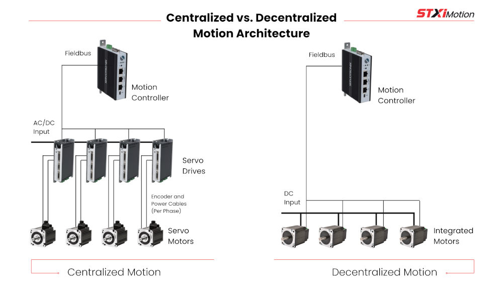

Integrated stepper motors require fewer parts, less wiring
Since the integrated stepper motors incorporate control electronics, CI was able to replace several different parts with one.
“We previously had to buy a brake from one company, a controller from another, and motors from a third… and then deal with all the integration,” Molleran said.
Figure 3: Traditional approaches require separate wiring for encoder, brake, controller, and motor. Integrated motors simplify power and control wiring. Commissioning software to complement motion controls, ServoStudio developed by Servotronix, satisfied CI’s engineers. Courtesy: STXI Motion
Integrated motors reduce machine wiring, as in the case of CI, where the controller is located near the backgauge, eliminating long wire runs.
“Instead of passing encoder, brake, and motor phase information back and forth over home run cables to a centrally located controller in a control cabinet, integrated motors only need power and CAN fieldbus connections. The latter is suited for long distances,” Molleran said.
