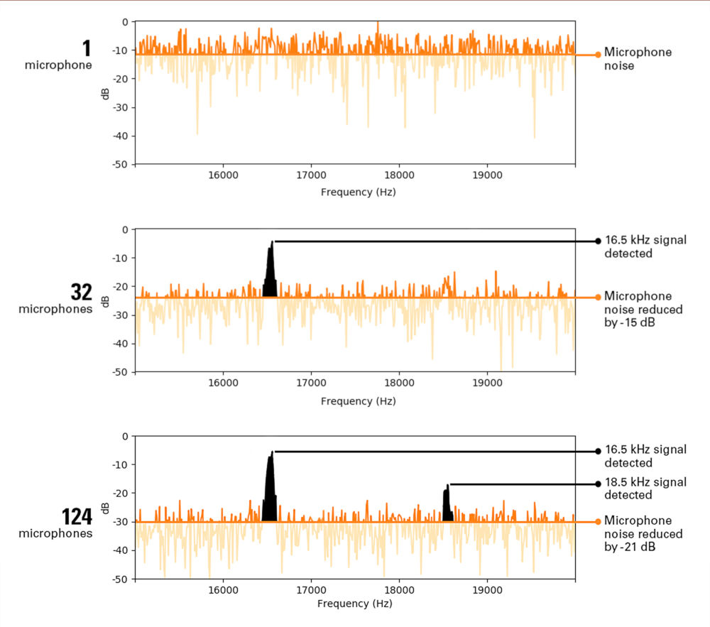

Figure illustrates how microphones impact the ability to 'see' problems. Courtesy: Teledyne
Figure illustrates how microphones impact the ability to ‘see’ problems. Courtesy: Teledyne

High definition (HD) acoustic imaging devices that rely on a series of specialized integrated microphones can be up to 10 times faster at detecting leaks compared to tradi­tional methods, such as the soap bubble and single-micro­phone ultrasonic options. Generally, the higher number of microphones, the better the acoustic performance. The optimal choice in this case would be MEMS (microelec­tron mechanical systems) microphones, which are small, consume less power and provide better performance and stability than other systems.

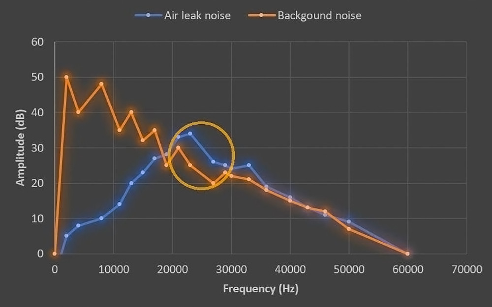

Noisy plants and manufacturing environments can make it nearly impossible to detect a leak with the human ear, so frequency range is crucial to leak detec­tion technology. The most effective frequency range for detecting compressed air leaks is between 20 and 30 kHz, as that range aids in distinguishing compressed air leaks from the background noise in a plant envi­ronment. The amplitude of machinery noise typically peaks below 10 kHz and trends down to zero at 60 kHz, and since there is a greater difference between air leak noises and background noises between 20-30 kHz compared to higher frequencies, it’s easier to detect the air leak in this range.
Air leak noise versus background noise compared to find the optimal frequency in a noisy environment. Courtesy: Teledyne

Microphone quantity also plays a large role in leak detection – specifically with very high frequency sound sources. To accurately hear these sounds, acoustic cam­eras must have a multitude of microphones, preferably close to each other, otherwise issues of spatial alias­ing will occur, leading to erroneous results and sound sources displayed at improper locations.

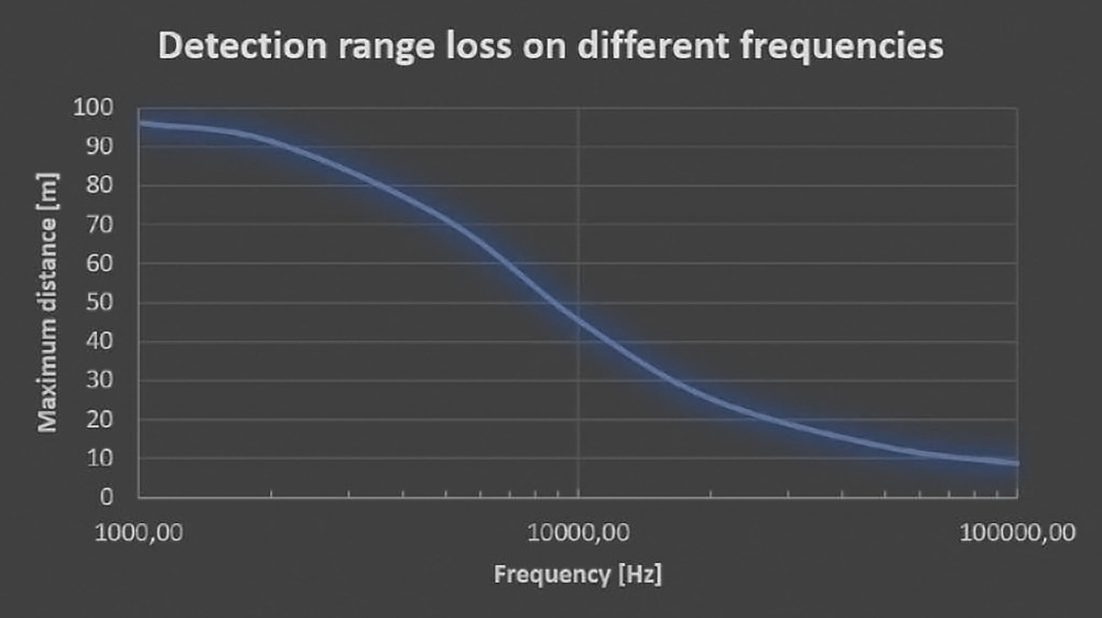

An illustration of detection range loss at different frequencies. Courtesy: Teledyne
